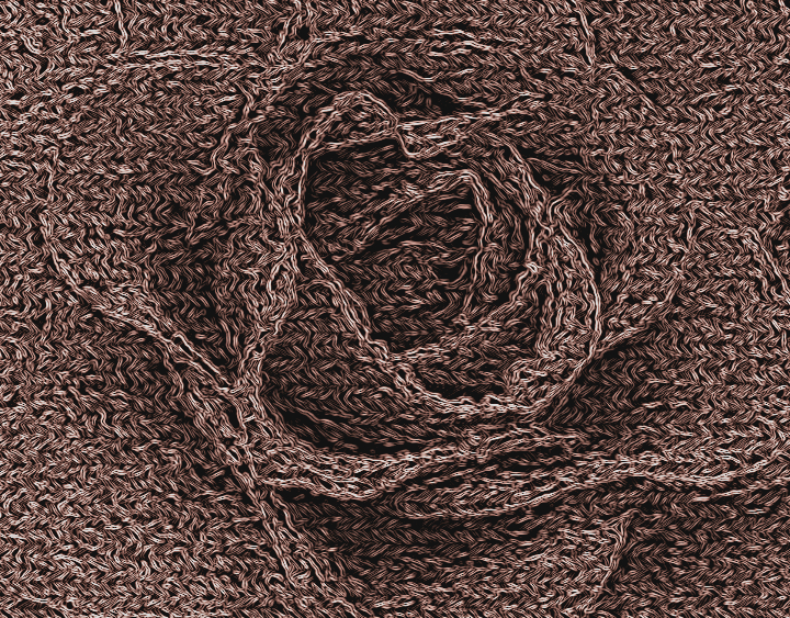

Thought I would do both horizontal and vertical ripple distortion this time (didn't resize, though). Also added simple image overlay to get some added contrast (re-colorized of course for the canvas color). Well; I suppose I should call this one burlap weave. lol

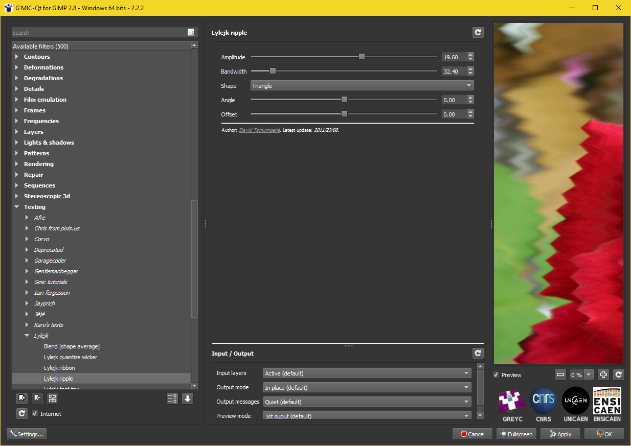

OK, Pat. What I do is first run Ripple (by the way, samj placed a better ripple in folder for g'mic; takes care of edge issues so I highly recommend using her preset), then I rotate 90 degs and run Ripple with same settings. I then run super pixel, horizontally flip and run Ripple again (same settings), then horizontally flip and rotate -90 degs to right the image and and horizontally flip and run Ripple again and then horizontally flip to recover. Sounds complicated, I know, but it's not that hard. Now with this result, I run the wicker process as I outlined. :)

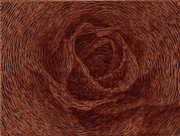

Lyle, this is as close to yours as I have been able to get. I have followed your instructions and even did the convolution step. Are there some changes in the default settings I should make? It does not have the "woven" look as it gets away from the center of the rose. I apologize for being such a pest but I really love this effect and would like to be able to do it.
 Post subject: Re: Ripple Weave Wicker Rose
PostPosted: Mon Apr 16, 2018 11:33 pm  (#12)
Posts: 12853
Your result actually really looks like a wicker basket, Pat. Fantastic.

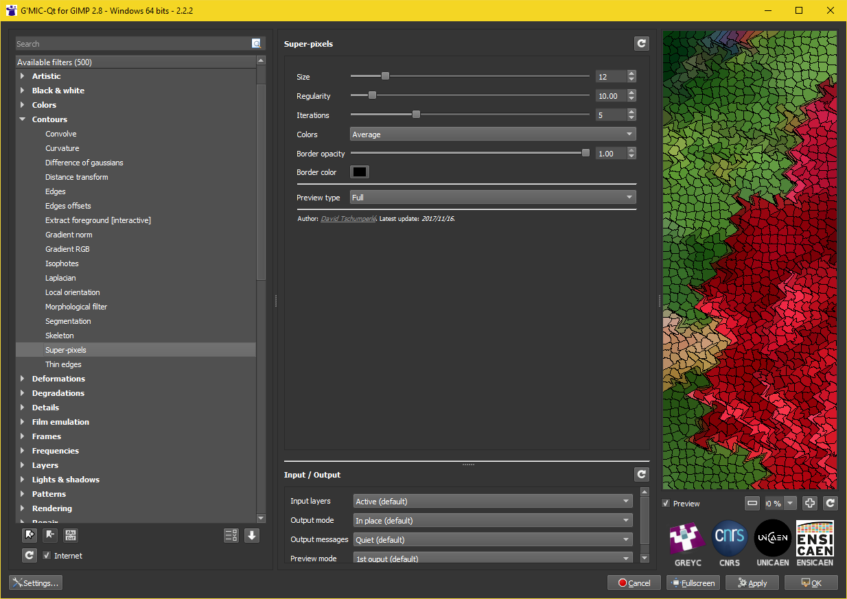

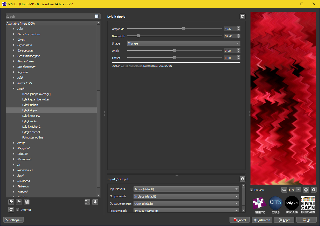

OK, Pat. Here's the steps used graphically.
ref: http://www.fontplay.com/freephotos/fift ... 606-24.jpg
Step one:
Step two:
Step three:

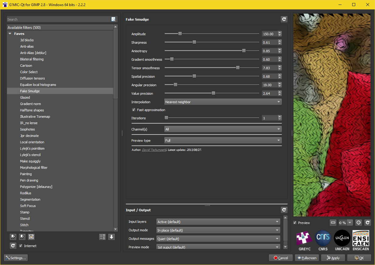

Now run Anisotrophic smoothing:

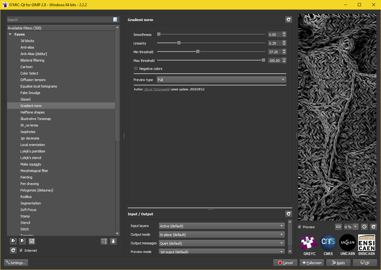

Gradient Norm step:

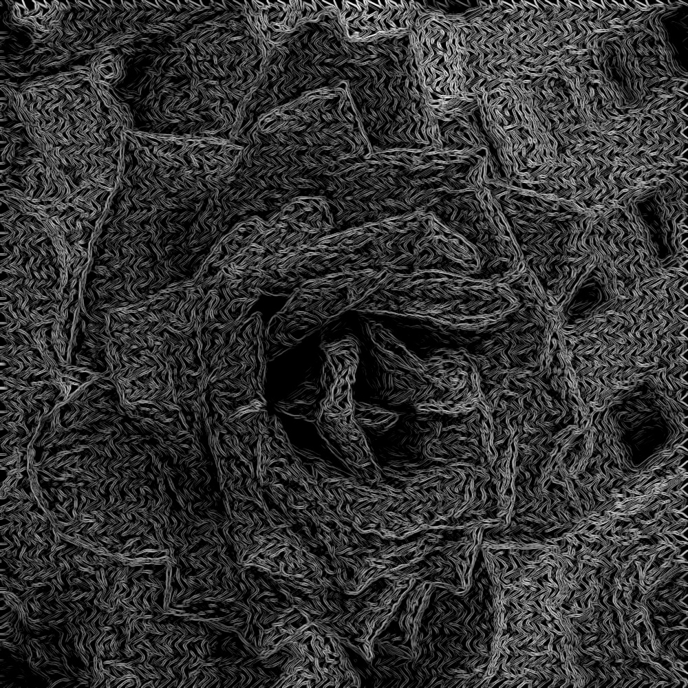

Result (no auto-level, colorize; just after the gradient norm step):

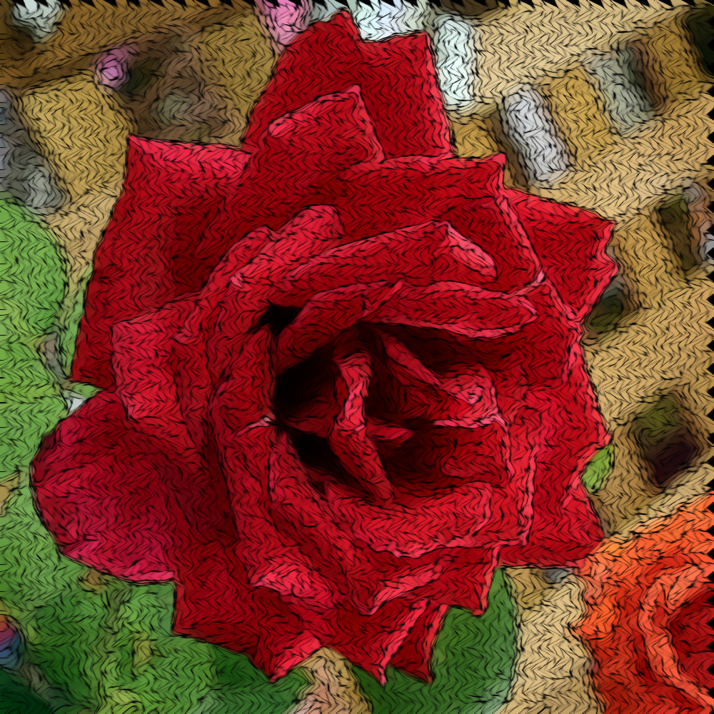

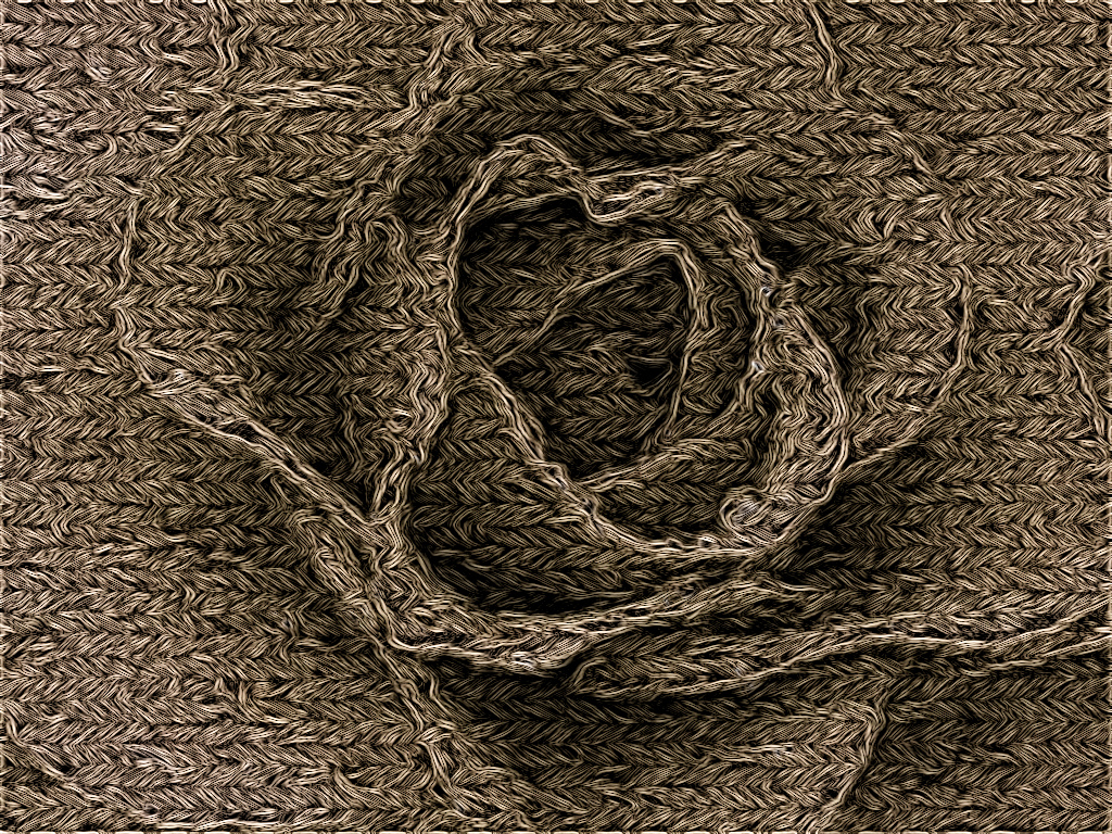

Lyle! Thank you, Thank you, Thank you, Thank you!!! :yes :tyspin
I finally got that Wicker Rose! Thank you for the great instructions. It could never be as good as yours, but I am happy with it. Thanks again!

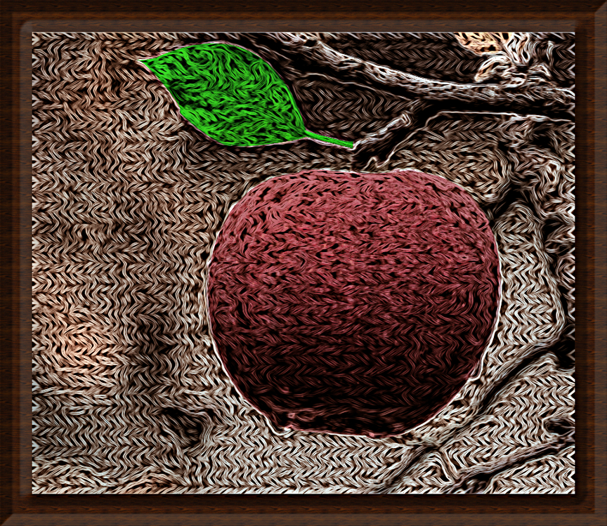

Lyle, you really have me hooked on the Wicker effect! Now, I am on a binge! Oh, well, I am having fun.
