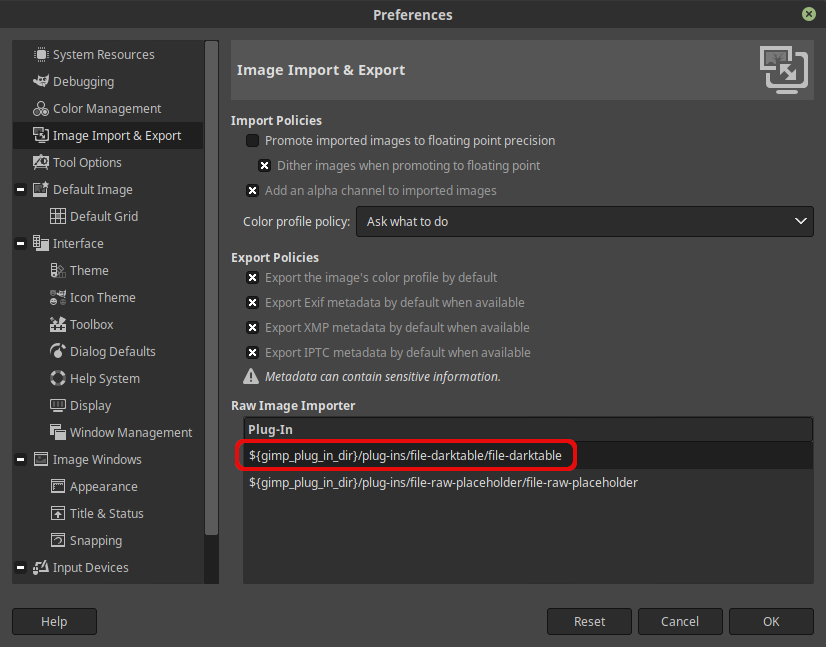

Perhaps you are unaware?
If you have both DarkTable and Gimp installed, you can have Gimp import RAW images via DarkTable. After editing the raw file in DarkTable, it goes directly to Gimp (in 32-bit RGB) when you close DarkTable.

I am aware that Gimp and Darktable somehow work together. I am just not aware about the recommended workflow. If I can do a lossless import from Darktable to Gimp that might be a good way then.
