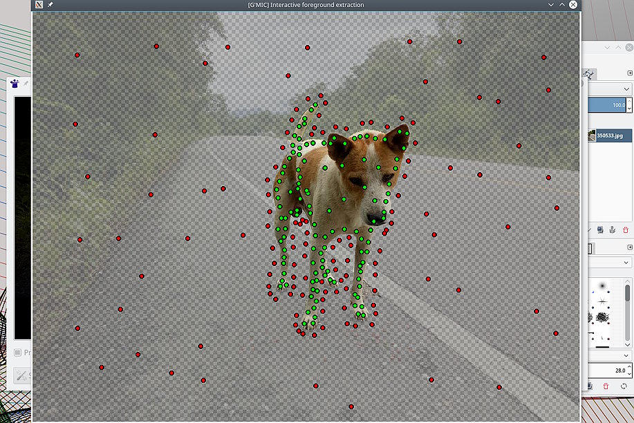

Gmic interactive foreground extract. (in the contours menu)
An image like that only takes a minute to dot around the boundary, hitting space bar towards the end to check the extraction
Any missing bits can be touched-up with the clone tool or use it to make a layer mask. Often quicker than painting in a mask.
