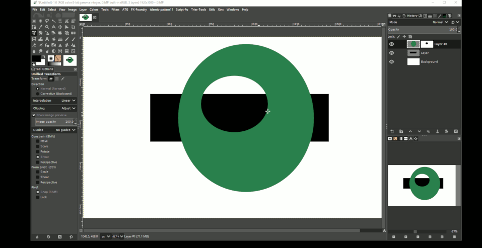

Hi, if i create a layer, then a shape on that layer that i fill with a colour,
then i create another layer with another different shape.
I add a mask to the top layer so part of the shape below shows through,
but then try to use any of the transform tools except the move tool on that layer, the mask moves differently to the layer, I'm sure it didn't used to do that,?
the move tool does move both the layer & mask in sync with each other,
I can move the mask correctly independently by clicking on the mask but clicking on the layer used to automatically inc the mask to be transformed in the same manner,?
Am i doing something wrong, do i have to now apply the mask before transforming that layer?
Thanks
(I just reloaded GIMP 2.10.8 in case something had got lost )

Posts: 2627
It is probably a bug, since it works as expected in Gimp 2.8
However, for Gimp 2.10 try setting Clipping to Clip in tool options for whatever transform tool in use at the time.

Joined: Mar 02, 2018
Posts: 25
Excellent, that works, I'm working at the moment so just had a quick try but the mask transforms in syc with the layer when set to clip,

PostPosted: Fri Dec 07, 2018 3:42 am  (#12)
Posts: 2627
I reported this as a bug, but already reported
This is a duplicate of #2473 (closed), which is already fixed in git. Frankly, I'm surprised it took that long for someone else to notice :)
So, should be fixed when Gimp 2.10.10 comes along.
Posts: 25
Thanks, that'd be good, after having chance to play with it a little & reloading Gimp 2.10.8 (which didn't fix it) although the clip feature does make it work in sync it does crop anything out side the canvas area,
