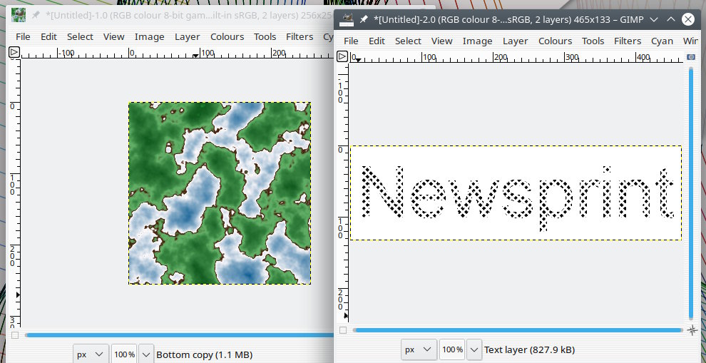

You can get them here https://github.com/GNOME/gimp-data-extr ... er/scripts looks like
Depending on web browser / OS there can be snags downloading. If you get something with line numbers, right click on RAW and try a Save-as
A couple in Gimp 2.10

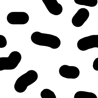

The offset method.
This is our hypothetical pattern:
Now you go to Layer -> Transform - > Offset and use the "Offset by x/2, y/2 button".
After that it looks like this, and you know where you need to paint some more to make it seamless.
This is what it looks like after i did more work.
And finally the new seamless pattern (scaled down)
