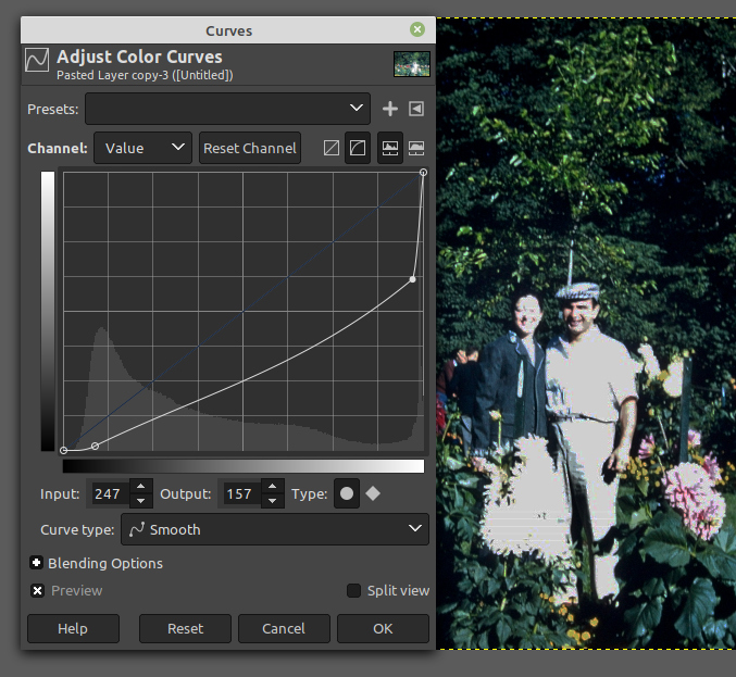

BTW, I also used the curves tool. If you only want to work on the lighter parts of an image, create an anchor point around the middle and only bring the upper right point down on the vertical scale on the right. See picture.
I also used a mask of a grey scale copy of the image to make the selection of the brighter parts even more precise. (Duplicate layer, right click on the layer the the layers TAB, 'Add Layer Mask' and then 'Greyscale copy of layer'.
