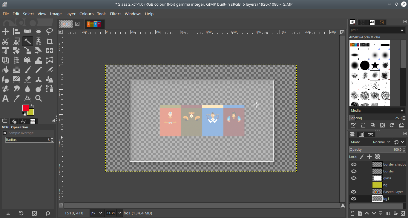

Hi, How do I place a glass surface over a plain colour background ? Something like what Aero did. When I tried with a plain background, the blur simply dissolves into it and show no effect of a glossy surface.
Please see bg + blur try which I did. It does not have any glass effect at all. Do we need to introduce turbulence into the blurred layer ? I don't know how to do it in a uniform way. I tried to do it using brush, which gave very poor results.

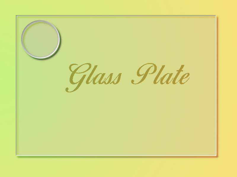

I'm not quite sure what you are looking for and I don't know Aero either, but I have been known to play around with glass effects :)
The image below uses a filter to produce various thicknesses of flat glass - the rectangle represents a thin glass layer and the circle a thicker glass layer on top. Let me know if this is what you are aiming for and I will post the filter.

Yes, yes. :)
I would like to imitate the thin layer as we see in the rectangle above. Thanks.

Adding a border method is very effective. I would like to add some blur to it as well. Not a 100 % see-through glass. I tried adding blur to the white layer. But it does not make any effect on the background image. But it works great with a plain colour background.
Any ideas on how to do some glossy glass than a perfectly transparent glass will be awesome. Thanks.

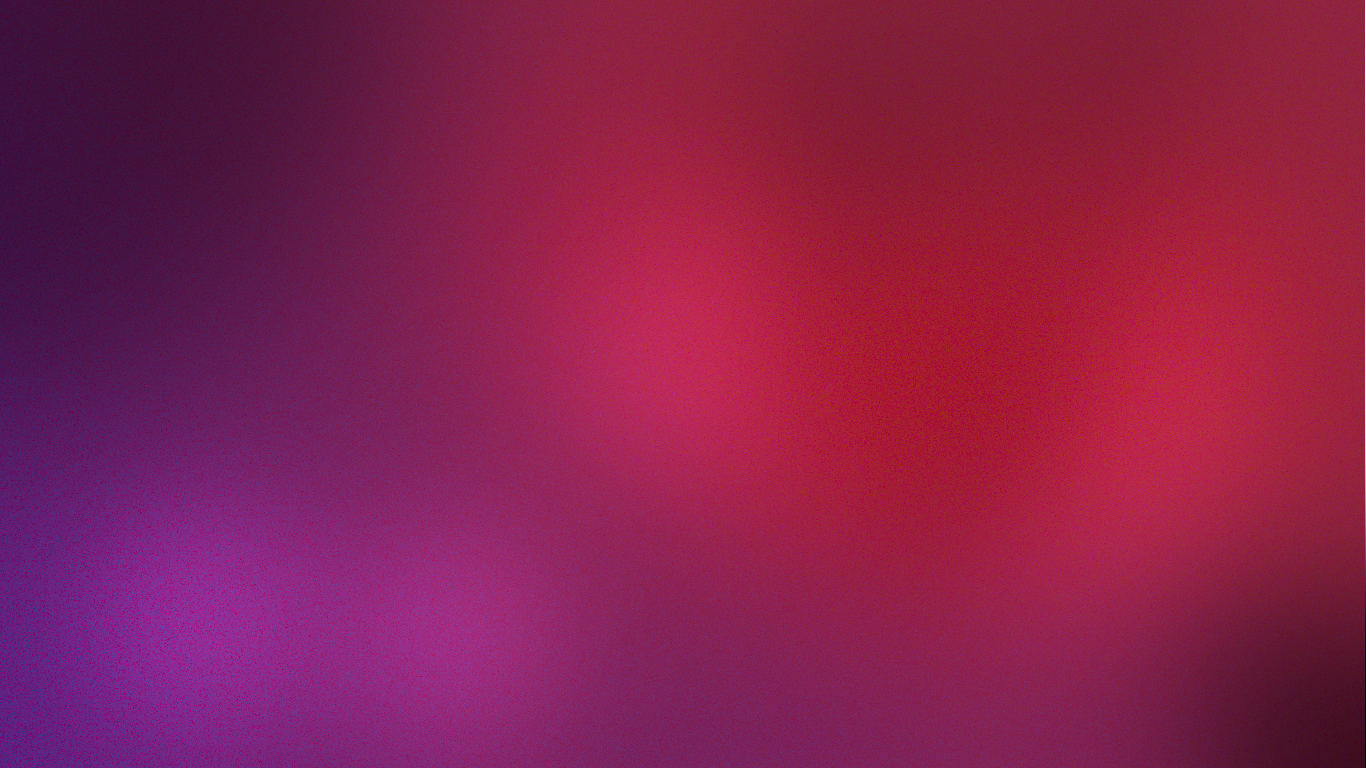

meetdilip - I was intrigued by your post above (#8) so I had a very quick play at your target wallpaper; no glass, just FG/BG gradient, brushes and blurs.

You are awesome. I missed this post since this was in page 2. :(
It will be great if you can give some description of how you did it.
 Post subject: Re: Glass plate above an image
PostPosted: Mon Jun 01, 2020 9:39 am  (#13)
Joined: Nov 19, 2019
Posts: 209
Your tips were great. I didn't think of a brush stroke with a large brush size in white colour. Once I painted a few soft areas, I applied blur to the white brush stroke layer. Then added a bit opacity to it. The plain gradient wallpaper was in the layer just below it. I used " Luminance " mode on the brush stroke layer which now has blur and opacity.
