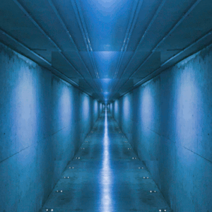

I wanted to see if I could make an 'infinite zoom' in Gimp.
I figured out a method but haven't perfected it yet so sorry.
First I used Filters>Map>Recursive Transform - it's fun to learn to use.
Then I used G'MIC >Deformations>Zoom to zoom into the recursive transform by a set amount. What happens is the pixels get progressively bigger.
My solution is to paste and scale the original layer into each version of the on stage screen. There are less than 20 Gimp frames and this always makes a clear image. The paste and scale is not very scientific and there is human error because the frame can get vague.

Hi Nidhogg and racer. You guys can understand these are not too easy to make.
I improved the technique. Still using Recursive Transform and G'MIC Zoom. Now I duplicated the bottom layer and added 0.05 zoom to each subsequent layer. There are 26 layers in this but I doubled them to get a better speed.

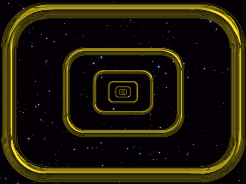

That one looks better. I just found out you can do it all in G'mic using Droste and Zoom. Here is a quick 4-frame animation. I used reversed zoom, then reversed layer order. This reduces blur.

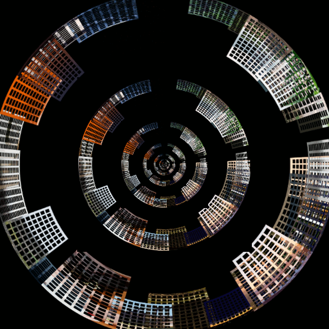

I was intrigued how these were made and had a try at scripting the effect, got a script up and running but still needs a couple of niggles ironing out
steve

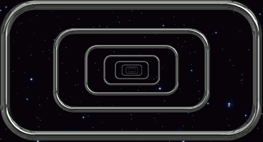

Yes, I used G'mic > Frames > Droste. Reverse Zoom is done entering negative numbers so you are zooming out. There is no blurring of quality this way because the image is downscaled vs upscaled.

The pulse is still visible, but I tried to fix it by changing the duration of first few frames.

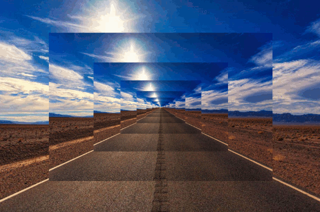

Thank's Steve, this makes it super easy. Tested with 16 frames set @ 60 ms. I'm running the same as Nidhogg.

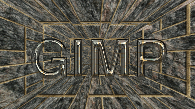

G'mic has a frame filter called "Cube" and I used it to make a tunnel out of a stone texture that I made. It looks cool in this animation and I even managed to make the wall reflection on the chrome text. :bigthup

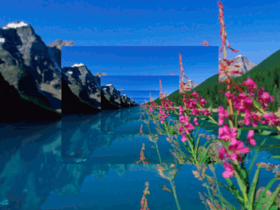

Its a long paddle to the end of the lake..... :hehe ...
Many thanks Steve, you made life a lot easier....

Negative meaning less than 1 on the zoom scale. 1=normal size, 0.95=5% zoom out and so on. I used guides to see where I needed to stop. I then cropped the image in the end.
