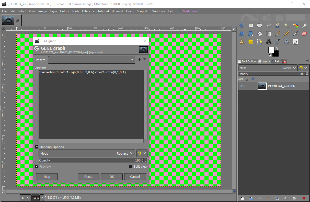

to specify a color you can use rgb(r,g,b) or rgba(r,g,b,a):
I recommend reading the information in the GEGL Graph dialog:
Kevin
