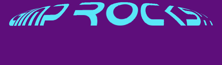

The only thing I'm having trouble with is creating a frame... I think I have the Beautify plugin, but I'mm getting an error message....
"Animation WorkShop Warning
Error while executing script-fu-animation-workshop:
Error: ( : 1) eval: unbound variable: plug-in-simple-border"

'Simple Border' is one of the Beautify group of Plugins do you have it installed?
