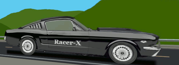

Perspective filter.

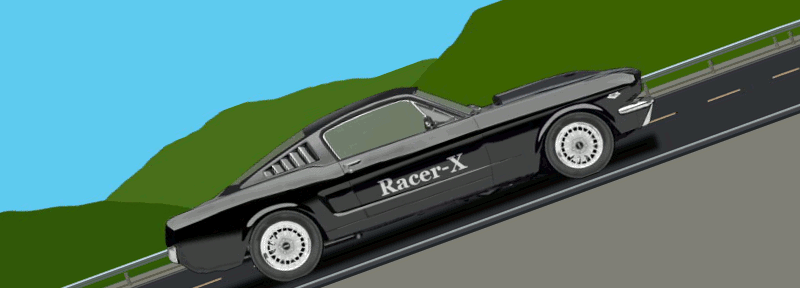

Great work Tas and teapot. Here is an experiment using the "Smart Rotate" filter to drive the Mustang up a hill.

I like the cinema-style reverse rotating wheels racer-x :)

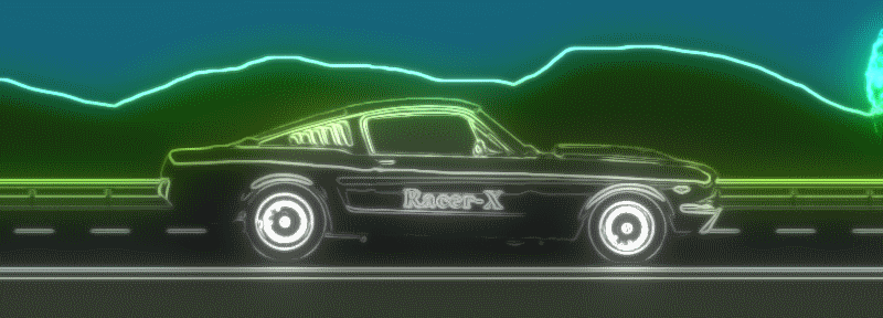

Excellent work Tas.
Here is a "Neon" filter by Joan Rake under "Testing".

racer-x, The neon is very effective and I like the background lighting reflecting on the car.

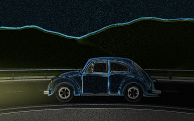

Nighttime look with samj_Angoisse_en:

Well done teapot, especially the headlight illumination on the road ahead. That was a nice touch.

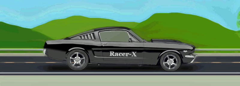

Nidhogg wrote:
Like the Mustang Neon too, but the dashed line is running forward.
Yeah, it's an optical illusion. Anyway, upgraded the rims and applied "Dream Smooth" to the background only (via selection)....

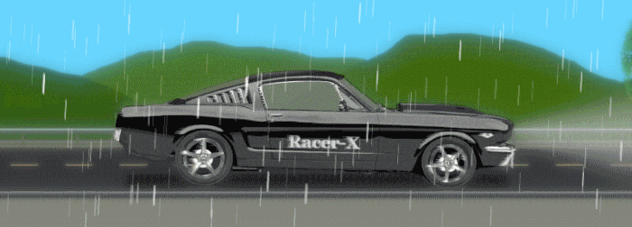

Just playing around, I made a more realistic rain animation. I used "Blur Bloom" to make the fog. I used "Wind" to make the water spray effect. I made the headlight beams and added rain.

That's pretty amazing racer-x considering it's just a GIF :bigthup
