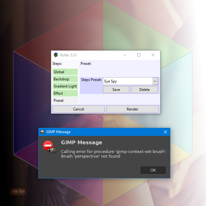

PostPosted: Wed Dec 15, 2021 2:15 am  (#31)
Hi Charles.
This time I will be a little whining :mrgreen:
In How to install.txt:(with: Roller 3.01)
    Here is how the installation is structured in Windows 10:
    > …AppData/Roaming/GIMP/2.10/plug-ins
        > Roller.py
        > Roller 3
           > Frame
               > image files for the Frame Over image-effect
           > Module
               > Roller modules
           > Preset
               > Preset folders
Following this instruction does not work.
Works when (Roller.py with a big R):
        > Roller
         > Roller.py
         > Resources
            > Frame
            > Module
               > Roller modules
            > Preset
               > Preset folders
Also for Preset instructions:
How To Reproduce The Slice Sample
This sample was made with Roller 3.
1. Place a copy of the 'Preset, Steps﹎Slice Sample.pkl' preset into Roller's installation at:
    .../Roller/Roller 3/Preset/Preset, Steps/Preset, Steps﹎Slice Sample.pkl
Works when:
...\plug-ins\Roller\Resources\Preset\Preset, Steps\Preset, Steps﹎Slice Sample.pkl
