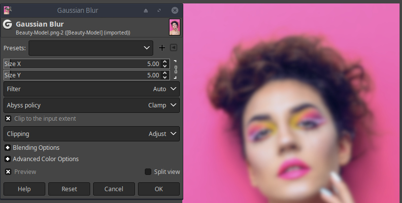

What are you trying to blur?
Any filter you are applying, affects only the layer that is active/selected.
From the background image I see, you are probably working on a multi-layer image, because the blur window shows lot of transparency.
5px gaussian blur looks like this on a fully filled or non-transparent layer.
use the :move tool in the preview window, I can see blue on the lower part.
