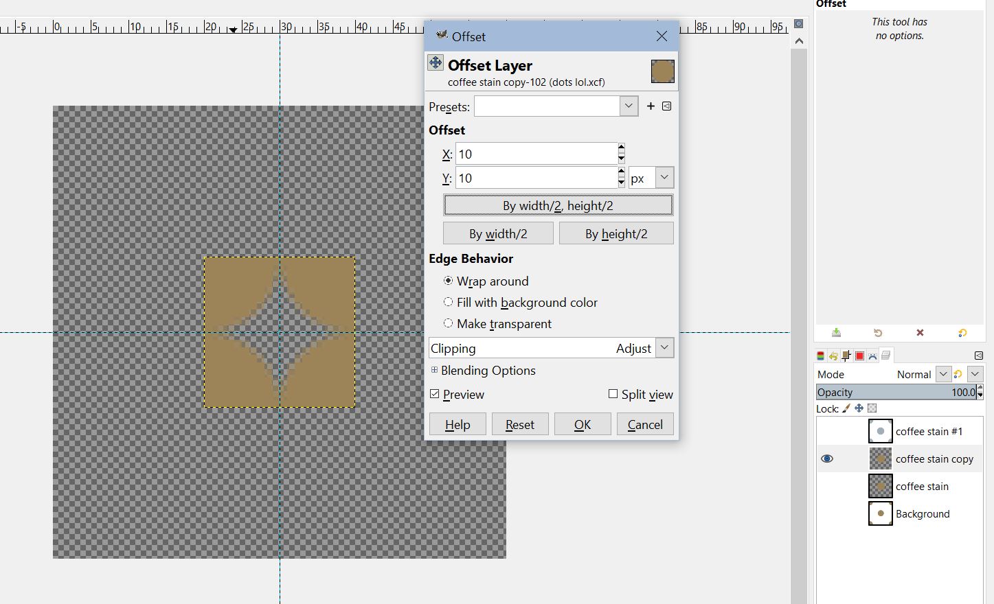

last night i made a blue dots and brown dots pattern, on white backgrounds, now im trying to make a brown on transparent background, and i keep getting this: instead of the 1/4 dot in each corner with one in the center, why?

It is doing this because the layer is only as big as the dot! lol. When i do seamless in the filters it makes it a square, and that was very confusing. So to make the dots, create a larger area, say 100x100 and then merge the dot with that layer and run the offset. I hope that helps anyone else.
