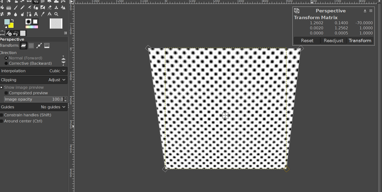

One way (example)

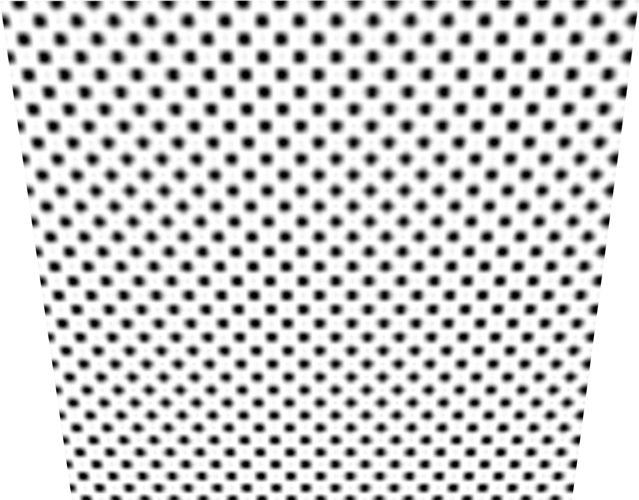

...or
output (expanded using fit canvas to layers after transform)
output (not expanded using fit canvas to layers)

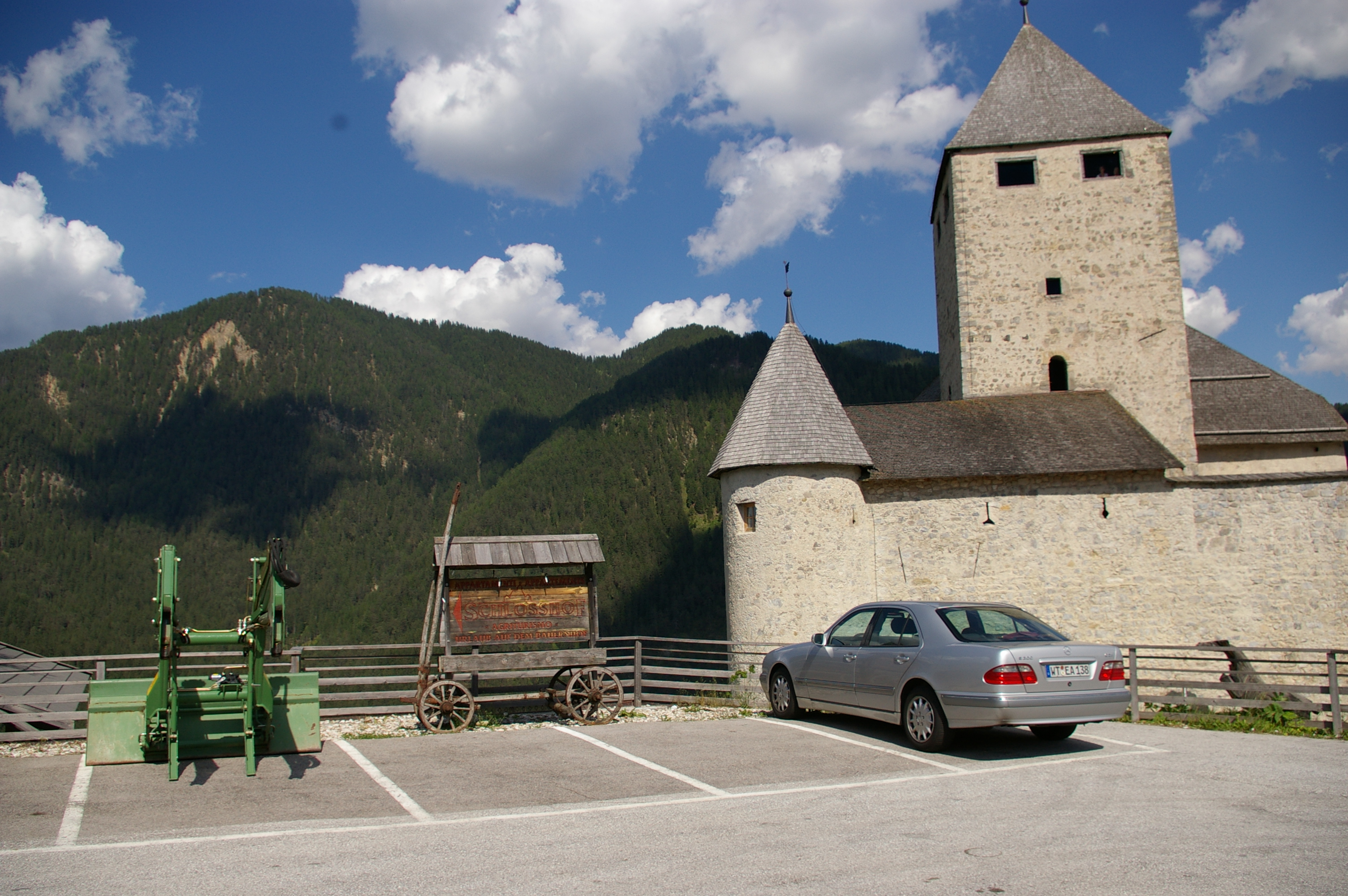

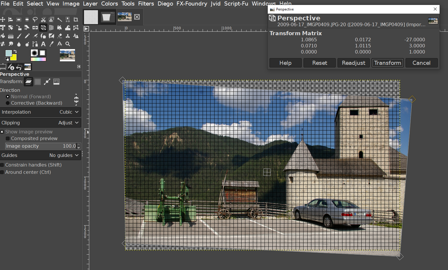

A complex picture to adjust in perspective:
-original
-show grid, then activate perspective, then move corner as needed
-crop as needed

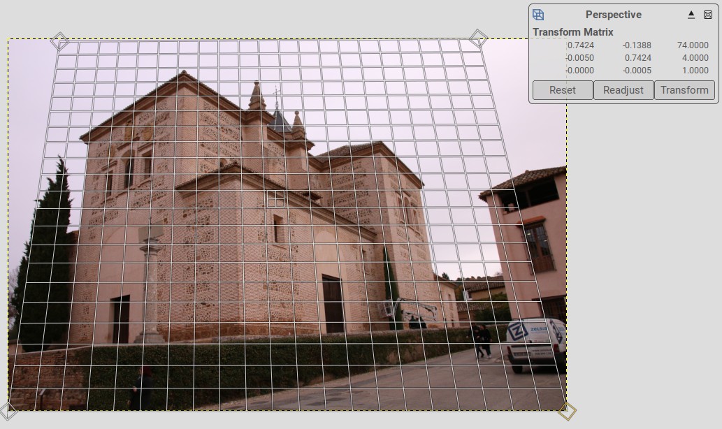

The easy technique is to first put the Perspective tool in "Corrective" mode.
Then you make the tool show a grid ("Guides: Number of lines" option) and pull the corner markers so that the grid is parallel to your verticals.
And then you just apply the transform.
As you can see in many case applying the exact correction (verticals are truly vertical above) make the perspective almost inverted (possibly because we are used to see these things from below). This could be worse for skyscrapers, depending on how far the shot is taken.

An example with the @dinasset's picture
move the selected transformation to align fence, car park lines, while transforming as you can adjust transformation as well
then here many options:
- clean the top cloud with the clone tool
- or the eraser, to bring back the original below
- or use a mask to bring the original below
- clone/cut the "misaligned mountain"
- or just copy this part from the original and paste it on top on a new layer, adjust/transform/mask to your liking
Patrice
