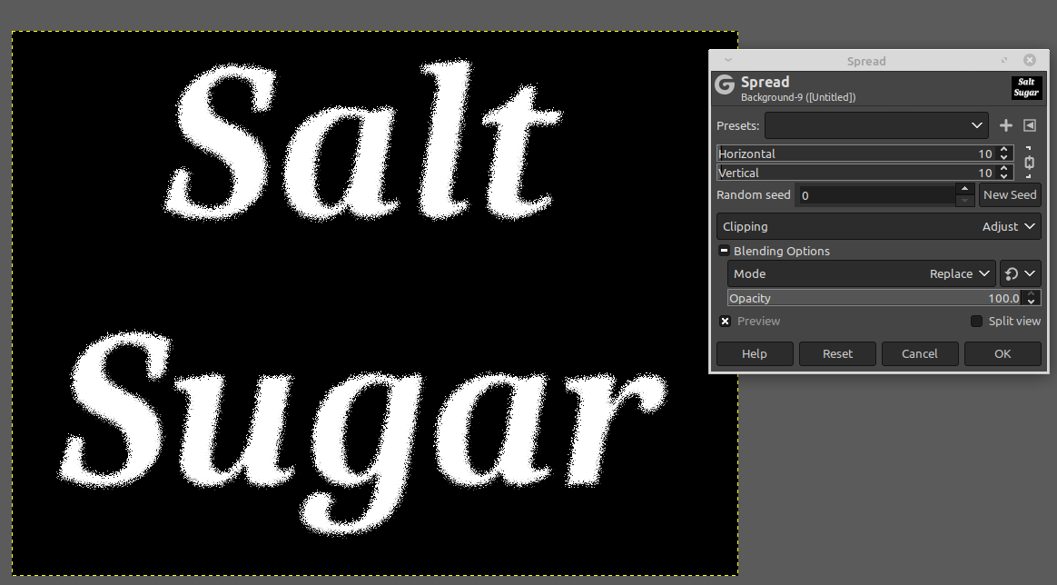

Does anyone have an idea to create something like this?
I once used this with Adobe photoshop.
If it's a brush I'm already satisfied
 Post subject: Re: Salt& Sugar
PostPosted: Tue Aug 17, 2021 4:53 pm  (#2)
You can use Filters > Noise > Spread.

How stupid of me...didn't think of that at all...thank you!

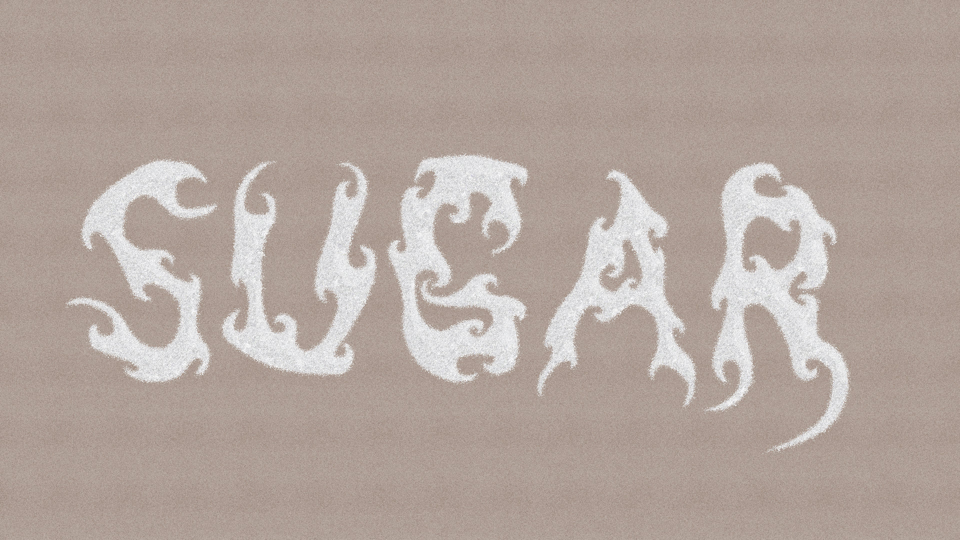

OK; sugar this time. lol
Most fun I had in months. Anyway, wanted bigger grains so used a hypertufa texture instead of diamond dust one. Also added a bit of sparkle (subtle) since I could. :)
