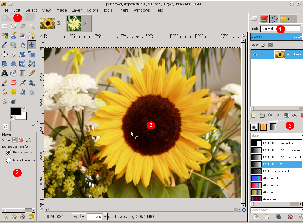

Yes , sorry to say - but we are creatures of habit (Well I am)
I like my interface (main window) to be set up like describe and shown in the Gimp Docs
Please See attached no. 1: "single-window.png" (sorry cannot post a url OR "img" cause "I'm a new user")
So we are talking Single Window Mode and please pay attention on dock 4 and particularly dock 5 on the right side
But I got this when I for some time ago updated Gimp
Please See attached no. 2: "New standard mode.jpg"

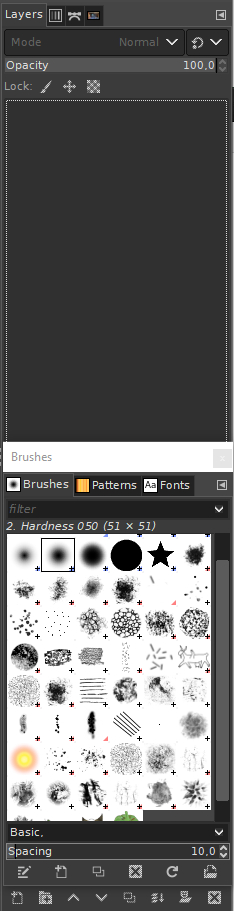

The "Layer" dock no. 4 is now at the bottom and Dock 5 is at the top compared to the usual "standard layout"
When I try to rearrange, I loose the dock at the the bottom in the right corner and are left back with only ONE big right dock
Then I can make a "hang-loose" dock and but it on where I like it to be - but you know its not the same - see:
Please See attached no. 3: "My Workaround.jpg"
How can I get back the two docks on the right side (without reset all setting)?

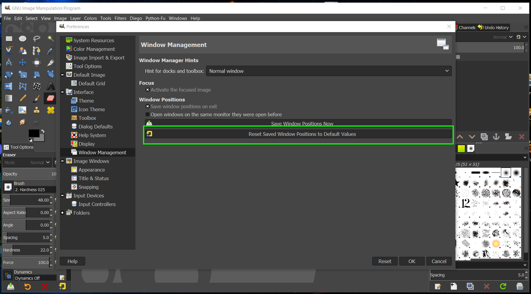

You could try to reset the window positions.
Navigate to: Edit → Preferences → Window Management.
Click the button for Reset Saved Window Positions to Default Values.
Click Ok.
Close the Preferences dialog and restart GIMP.
To see if this helps.

I would definitely go with Wallace's suggestion too as there is something wrong there. in the 'new layout' you have the layers toobar down the bottom under the brushes box. The toolbars should be under each box. Unless rich knows of an easier way.
Make sure once you do get all the windows in the correct positions that you check the box 'Save window positions', in the preferences area.
