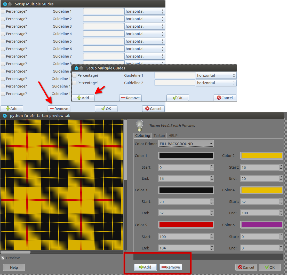

 Post subject: Re: Create Ofn-tartan (with preview).
PostPosted: Tue Nov 23, 2021 2:36 pm  (#9)
It was interesting for me.
Clan MacLeod Tartan Patterns
My answer - Ver. 0.5
https://www.gimpscripts.net/2021/07/cre ... eview.html

MareroQ wrote:
That's an excellent answer, script with preview are awesome :clap
If I may, IMHO there is few slight problems (tiny- very tiny :mrgreen: ) or place for improvement?
1 The number of colors/thread are hard coded to 6, thus we cannot do the MacLeod of Harris aka Macleod hunter, where the symmetrical threadcount "R6K4G30K20BL40K4Y8" is made out of 7 different threadcount/colors...
You don't want to put more than 6 choices, or the UI will become ugly, but IMVHO what could be nice is to add a button "Add" and a button "Remove" a bit like the plugin about adding multiple guides (I copy/paste the code if you ever want to look at it, as GC seems to not take in count .py)

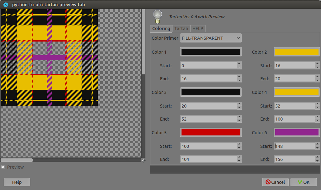

2 I found a little bug (it's a tiny one :bigthup ) when creating inside a selection, the first pattern (some time and depending the shape of the selection) got a strange behavior, see the difference between the green square and the red square
EDIT (bugs):
2 more bugs
a) it does not add the 6th color
b) Also past a certain number, it give this
Note: "Render Tartan" is "Yes" on the second tab, if "Render Tartan" is "Don't use" it will not give the alert/error.
3 There is not Ctrl+Z (undo) once generated, thus history is "broken", as an example if I use a script from Skinnyhouse which generate 100s of layers (Custom Font Layers from Font), and I'm not happy with the font, I just Ctrl+Z and it works fine, everything gets back as it was before to run the script.
Having said all that, there is no doubt in my mind that your plugin with a preview window is a huge improvement for us the users, I love it, I love the tabs, It's a pleasure to use it!
Thanks a lot MareroQ for this important improvement which allow us to SEE what we are doing :clap :jumpclap :coolthup .
Patrice

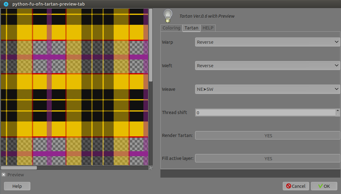

If it can help you debug, after my post #10, and with further "investigation", depending "Yes" or "Don't use" on the second tab it takes or does not take in count the 6th color
No purple color
Patrice
