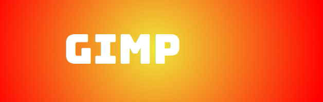

You should really be using Filters>Map>Map object to sphere for this. In four easy steps:
1) Create a rectangle image with aspect ratio = Pi (3.14...)
2) Add your colors and text
3) Image > Scale image and shrink it horizontally so that it becomes a square
4) Apply the filter
