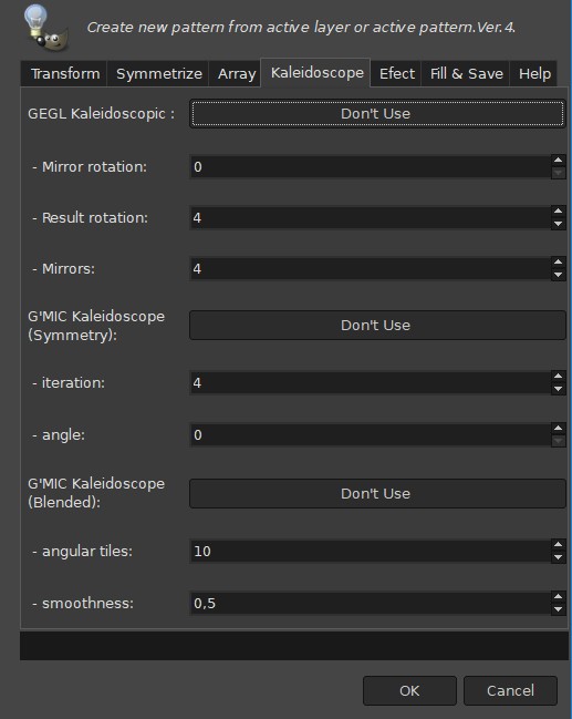

Hi Gimpquestion.
Since You started writing the python plugin, you can probably do it by using the sample code
https://www.gimpscripts.net/2021/11/pattern-editor.html
Good luck coding.

@MareroQ - this seems as it requires interaction with a GUI.
I want to automatically apply the same filter (with same specifications) to a large number of images in a for loop.
