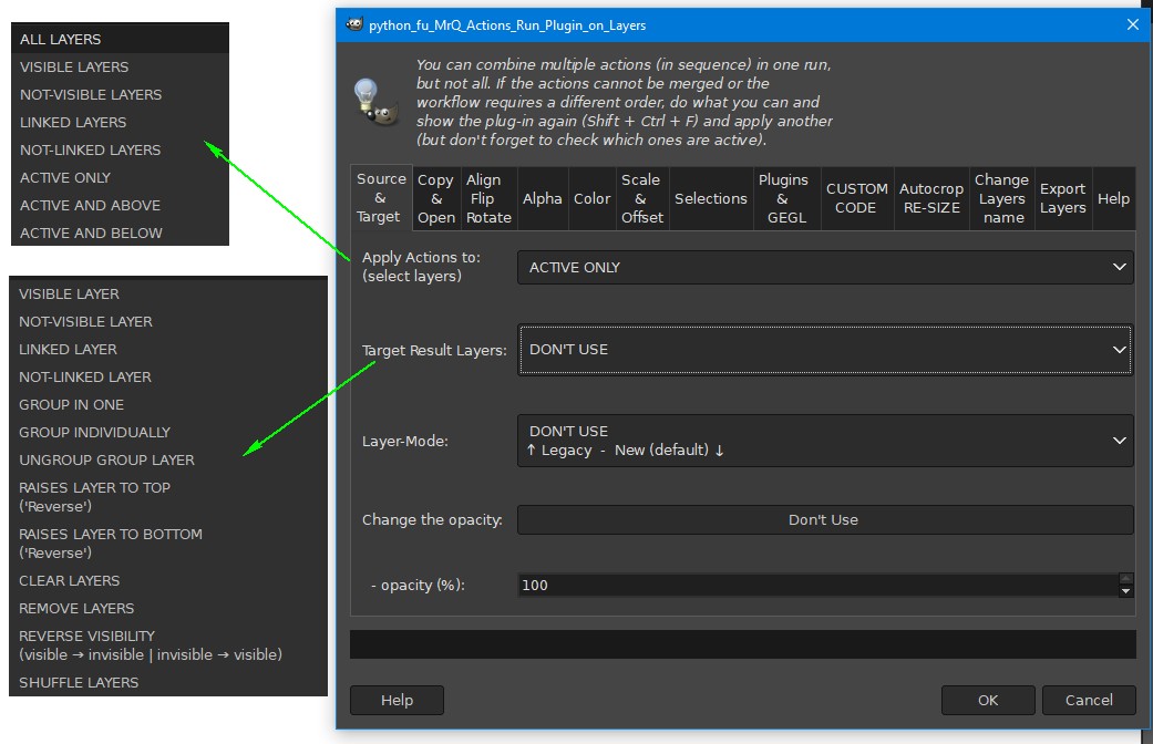

Congratulations on the new plugin type (utility class) and a little warning. :clap
I started similarly (just inspired by another plugin - run_code_on_visible_layers.py by Tin Tran code) and ended up with something few know and use (too complicated with too many options? :mrgreen: ).

Hi Marrek, thank you for the comment. I try to make the plugin simple, to many setting sometime confuse users.

It's a pity for words
lots of new ideas - no interest - so ARPL is dead. :hoh
