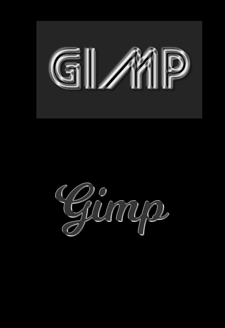

I don't get a good result with Chrome, no a nice chrome look.
I find the only great chrome look I like is this and I thank the auhor for this one.
My Gimp only has this filter in the Alpha to Logo version.
The results I got are far from what I've seen posted by other users in years past. :(
The size of the brushes directly influences the final result.
The Script uses brushes that in my Gimp's case weren't even available in the brush dialog; are in a folder - (gimp-obsolete-files).
I needed to change the name of this folder so that these brushes become visible inside the Gimp (I removed the hyphens "-").
Fortunately rich2005 and paynekj (Kevin) fixed the text version. The version provided by them works fine with my Gimp. Thank you gentlemen!
