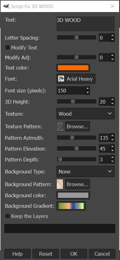

This script used to work well. It doesn't do nothing now giving error
Thanks in advance. It was created by Graechan, I think
Much better if it was a plug-in. ;)
3D WOOD.scm [7.43 KiB]
Downloaded 95 times

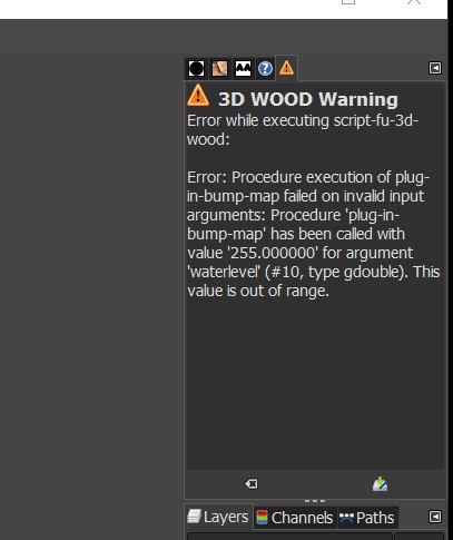

I must have a problem because it doesn't work for me.
I don't know what the problem is, I get this message in errors.

Looks like you are missing the old (GIMP 2.8.xx) version of bumpmap.

Issabella can you try this attached version for me? Make sure you keep the old one on your desktop.
If the attached scm doesn't work remove it replace it with the one on your desktop and unzip the attached bumpmap executable to your plugins folder and restart Gimp.
EDIT- SCM does not work so it has been removed. Sorry for any inconvenience this may have caused others.
Downloading and installing the attached plugin will work with the 3d-Wood script if your 3D-Wood script doesn't work.

Thanks a lot Rod! It works now perfect!!!!! :jumpclap
You are so kind to repair it for me. Thanks a lot.

Hi Mackenzie! vitforlinux fixed the plugin, you don't need the old "bump-map64.exe". If you want the plugin to work, you have to get rid of the old "bump-map64.exe". The "3D WOOD 299.scm" won't work as long if you have the old bumpmap plugin in your GIMP Profile: C:\Users\YourName\AppData\Roaming\GIMP\2.10\plug-ins. That been said, if you have plugins in your system (the one that I have written and other third party plugins), they need the old bumpmap plugin in order to work. I'm going to have to fix all my plugins that require the old plugin in the same way that vitforlinux fixed the 3D Wood.

In bumpmap one of the values has gone from a maximum of 255 to 1, and when I fix a script I make this change to allow it to work on current Gimp versions and on 2.99, so the old bumpmap plugin receives too low values.
