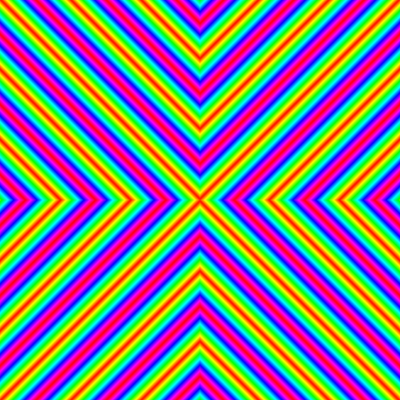

Links to plugin versions, suggest using the last one:
Version 1.0.0 Menu: Python-Fu -> Rotate Hue
Version 2.0.0 Menu: Filters -> Animation -> Rotate Hue...
Version 3.0.0 Menu: Filters -> Animation -> Rotate Hue...
Example outcome from the plugin saved as a gif:
The conversation was originally here.
Original post:
Issabella wrote:
:coolthup :clap teapot, you rocks!
I'd like to know how to do it. :hi5
Thanks Issabella.
I used Colours -> Hue Saturation and repeatedly changed the hue.
The hue goes from -180 to 180 so that's a total change of 360.
To wrap cleanly change the hue in steps that divide into 360.
For example I used a step of 20 which gave me 360 / 20 = 18 gif frames.
The process is:
Make some text filled with a colourful pattern, I used a pattern made with the Full saturation spectrum gradient.
Duplicate the text layer.
Set hue to -180
Duplicate the original text layer.
Set hue to -180 + 1 * step (in my case step was 20)
Set hue to -180 + 2 * step
Repeat duplicating the original text layer and setting the hue incrementing hue by step each time until it's 180 - step.
Delete the original text layer.
Add a background to all the layers.
Save as a gif.

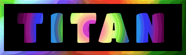

Hue saturation gifs
You only need to divide 360 by how many frames you want (18 x 20 = 360).
Duplicate first layer 17 times and go thru the -180 to + 180 in increments of 20.
I also processed the frames with G'MIC smooth abstract and then did the hue saturation again. I probably should not have used drop shadow on the first try :)
BTW thanks teapot for doing this.
diagrajamal1 thats cool.

Rotated hues on 2 canvases. On the first I selected by color on text with a clear background. On the 2nd applied a different gradient in the opposite direction. Used ofnut's 'interleave layers' to merge. Also used 'rename layers' with (20ms)(replace).
BTW. I open images like this one in a new tab and then bookmark it. Then I can post it without uploading again when a newbie arrives :)
