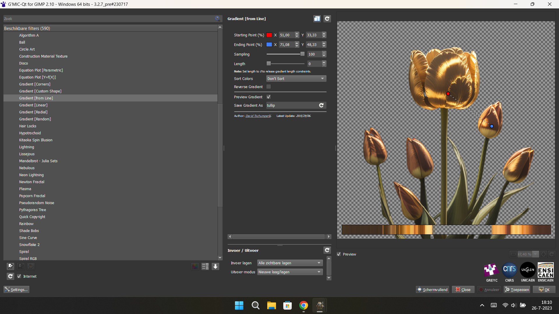

I'm trying to make a gradient from an image in G'mic. (gradient from line) But when I name it and save it I don't see it in my other gradients.
Did that in the past and it worked.
what am I doing wrong?

Looks ok to to me, that should work.
OK the gmic dialog, then go to the gradients dock and refresh the gradients.
45 second demo https://i.imgur.com/cu6FLcG.mp4

Thank you... unfortunately it didn't work yet.. but I'll keep trying.

It didn't work for me either, I found the gradient was in an unexpected directory. I ran this command to see where gmic wanted to put it:
gmic v + path_gimp
In the output, the 'Set status to' line is the one that matters. I tacked 'gradients' on the end, created that directory, and the gradient file appeared there.
