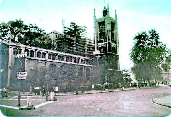

Hi all,
I have old colour photos in yellowed color but without scratch. My PC is connected to a 4K display and running Ubuntu 22.04 desktop
Please advise;
1) How to remeve the yellowed color.
2) How to restore their original color
3) How to increase their sharpness
Thanks in advance
Regards
sample photo attached

I think you can skip out on restoring color. Although there are still some colors information, it'll be very hard for you to restore them.

Before posting I have performed following tests:
A. On GIMP
1) Colors -> Curve
adjusting red/green/blue
2) Colors -> Hue-Saturation
Brightness-Contrast
3) Colors -> Curve
etc.
The yellowish color can be removed, some colors, such as grass, trees, etc can be restored. The photos are NOT very sharp after restoration.
B. AI Photo Editor online FREE
The result is worser than editing the photos on GIMP.
According to my recollection . I scanned the yellowish photos on Epson scanner and posted them on my website. Not all photos are so bad, only some of them.
I still have those yellowish photos and their negatives packed and stored on shelves. But it won't be easy for me to find them.
I have full knowledge scanning both photos and their negatives on mobile phone converting them to digital images. I have done them before. The mobile phone was nevigated via PC (Remote Desktop connection). I still have the fixture available.
But I have more than a thousand of photos and their negatives. It would take a long time to finish. Particularly the negatives, there is no marking on them indicating where they were captured.
Those photos were captured in the past when I travelled worldwide.
Suggestion would be appreciated.
Regards

A quick try at the sample image using the plug-in - col-cast-reduction.py - resulted in this image.
Applying a contrast mask to the result produced the following image, still not very good, but perhaps a starting point for further enhancement.

upload photo was restored by me before starting my posting but no sharp

I started since your well done outcome. So I started from your image. Then I tried to remove the blur, Filters - Enhance - Sharpen Unsharp Mask.
After that Colors - Exposure and added much Black Level. Finally Colors - Hue-Saturation and added Saturation.
You did a nice job :coolthup

Colors - Exposure
I don't remeber exactly I applied but about 30
And satutation, so the colours get a better look. :)

You could apply Advanced Tone Mapping after that. The background is better.
Filters - Enhance _ Advanced Tone Mapping
