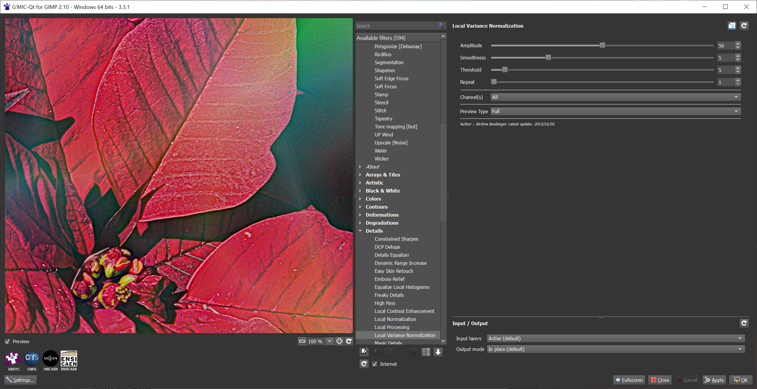

Now dup the base layer and then set the top layer to 50% opacity and merge down
Run Local Variance Normalization on this layer:

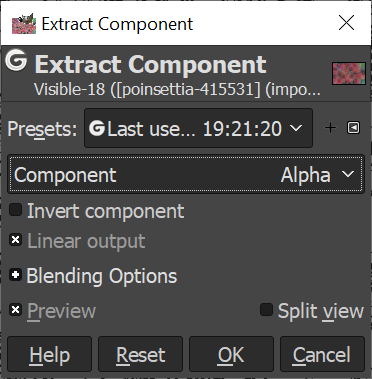

Now extract the Alpha channel to create the mask:

So long as you haven't given up on G'MIC, Pauline, you should be fine. The only GIMP thing I really used was the extraction of the alpha-channel to create the mask. :)
