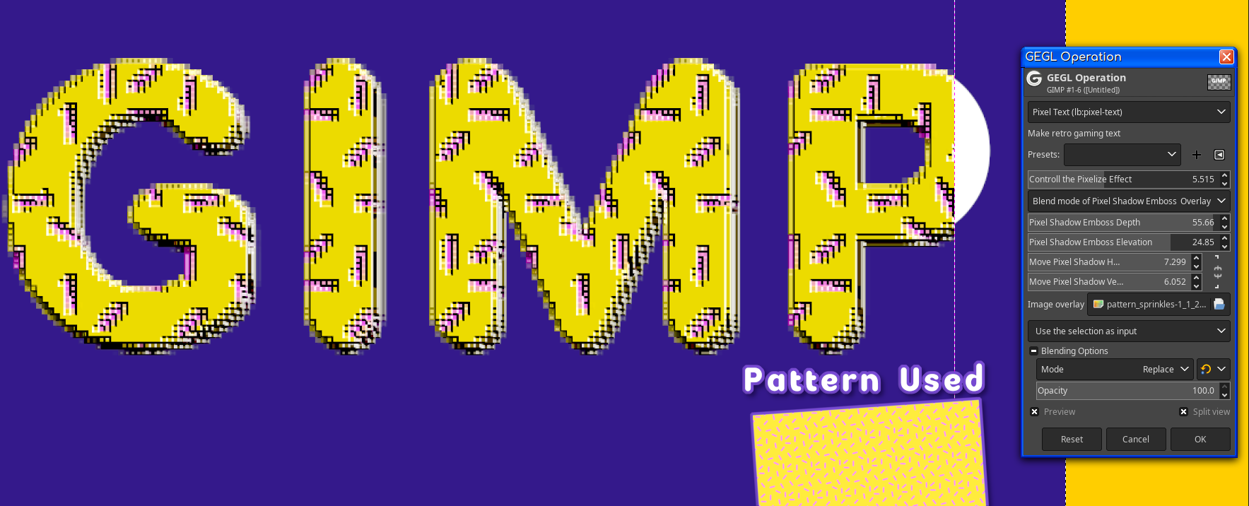

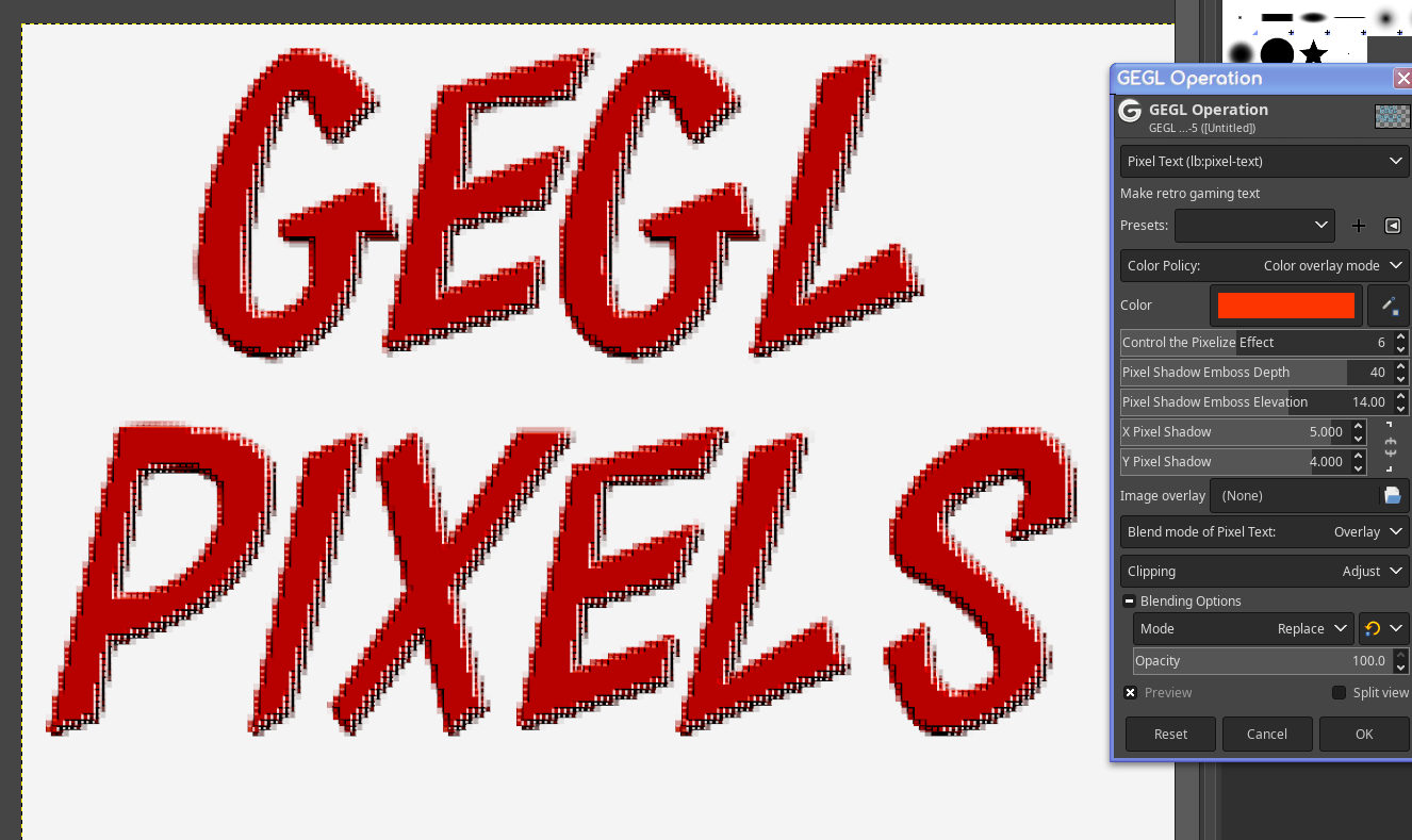

This thread exist for an up and coming Gimp GEGL plugin called "Pixel Text" here is a preview of its graph.
This one has an extra drop shadow.

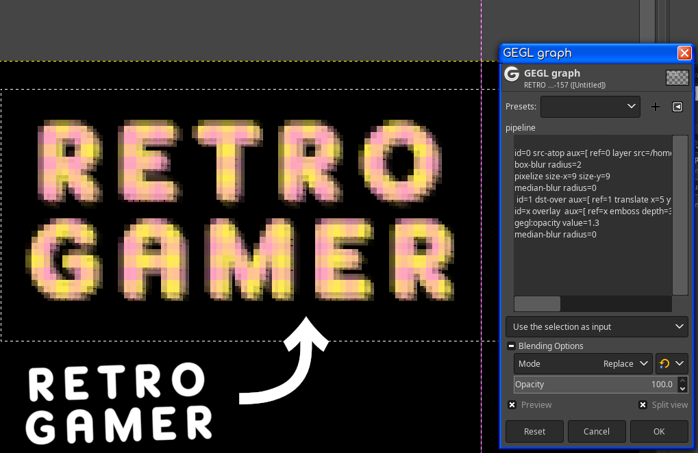

Here is the syntax itself to create this in GEGL Graph
id=0 src-atop aux=[ ref=0 layer src=image_path_here.png/jpg  ]
pixelize size-x=14 size-y=14
median-blur radius=0
id=1 dst-over aux=[ ref=1 translate x=5 y=4 levels out-high=0.2 saturation scale=1
id=x multiply aux=[ ref=x emboss depth=40 elevation=10] ]
gegl:opacity value=2
The node "multiply" can be swapped with "overlay"

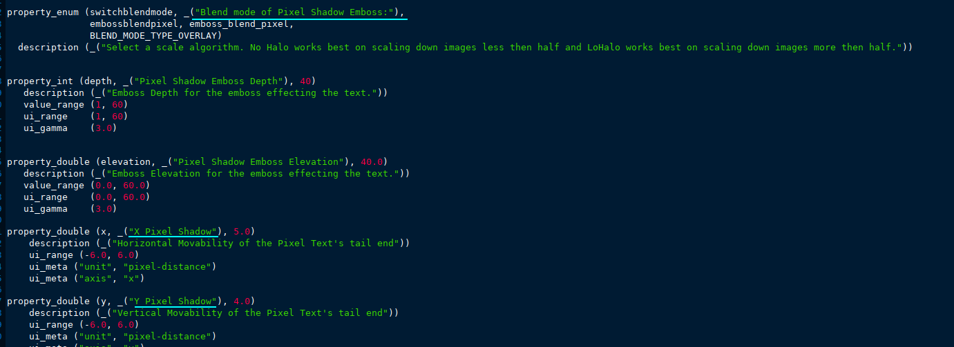

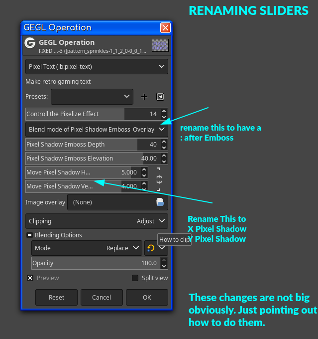

The GUI options are coming about
These are four sliders so far, Pixelize, Blend Mode Choice, Depth and Elevation.
property_double (pixelize, _("Pixelize Meter"), 14.0)
   description (_("Pixelization of the text."))
   value_range (1.0, 25.0)
   ui_range    (0.24, 25.0)
   ui_gamma    (3.0)
enum_start (emboss_blend_pixel)
   enum_value (BLEND_MODE_TYPE_OVERLAY,    "overlay",    N_("Overlay"))
   enum_value (BLEND_MODE_TYPE_MULTIPLY,  "multiply",  N_("Multiply"))
enum_end (embossblendpixel)
property_enum (switchblendmode, _("Blend mode of Emboss"),
               embossblendpixel, emboss_blend_pixel,
               BLEND_MODE_TYPE_OVERLAY)
  description (_("Select a scale algorithm. No Halo works best on scaling down images less then half and LoHalo works best on scaling down images more then half."))
property_double (depth, _("Emboss Depth"), 40.0)
   description (_("Emboss Depth for the emboss effecting the text."))
   value_range (10.0, 60.0)
   ui_range    (10.0, 60.0)
   ui_gamma    (3.0)
property_double (elevation, _("Emboss Elevation"), 40.0)
   description (_("Emboss Elevation for the emboss effecting the text."))
   ui_gamma    (3.0)
All sliders but "switchblendmode/embossblendpixel" correspond to this section of the .c file
gegl:pixelize's size-x and size-y parameter are combined into one slider meaning this one slider controls both x and y together in synch. X and Y of gegl:pixelize will not be separate sliders in this filter.
gegl_operation_meta_redirect (operation, "pixelize", state->pixel, "size-x");
gegl_operation_meta_redirect (operation, "pixelize", state->pixel, "size-y");
gegl_operation_meta_redirect (operation, "depth", state->emboss, "depth");
gegl_operation_meta_redirect (operation, "elevation", state->emboss, "elevation");
Switchblendmode/embossblendpixel corresponds to this section of the .c file. Only two blend modes can be choosen "gegl:overlay and gegl:multiply"
/* This is where the stateless blendmodechange gets swapped for multiply or overlay.
"switchblendmode will be its property name in the GUI" */
  GeglNode *blendmodechange = state->multiply; /* the default node is multiply  */
  switch (o->switchblendmode) {
    case BLEND_MODE_TYPE_OVERLAY: blendmodechange = state->overlay; break;
    case BLEND_MODE_TYPE_MULTIPLY: blendmodechange = state->multiply; break;
default: blendmodechange = state->overlay;
We are not done making the filter yet and this code will NOT compile

Test this filter without installing by pasting this syntax into Gimp's GEGL graph. This filter works best with an image file upload
id=0 src-atop aux=[ ref=0 layer src=/home/USERNAME/Pictures/Magic/pattern_fills/pattern_plaid-pattern-2_1_3_0-0_0_1__ff8ab3_00e1ff.png   ]

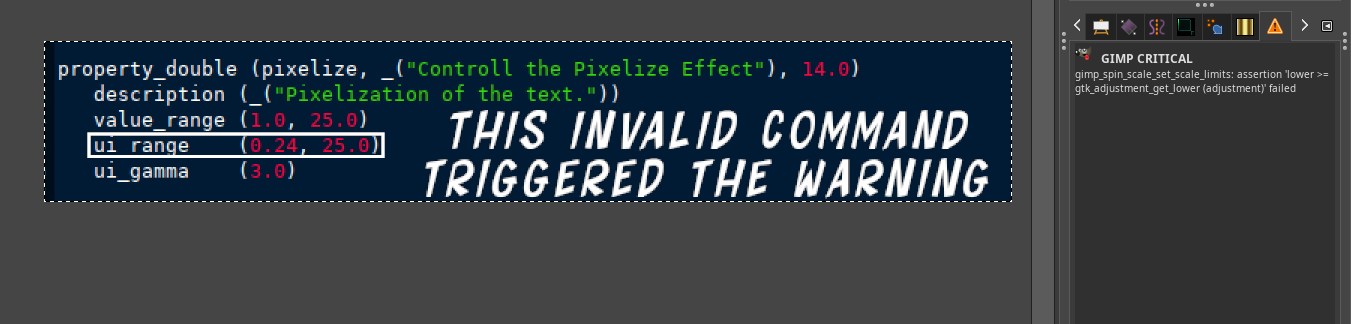

/* This is Properties (part 1) where properties are shown in the GUI based on their definitions in Properties (part two)*/
   ui_gamma    (3.0)

Its missing some of its GUI sliders that I planned., but the blend mode switcher, pixelize slider and emboss features work.
This filter is NOT yet complete.
New properties were added for GUI sliders
property_double (x, _("Move Pixel Shadow Horizontal"), 5.0)
    description (_("Horizontal Movability of the Pixel Text's tail end"))
    ui_range (-6.0, 6.0)
    ui_meta ("unit", "pixel-distance")
    ui_meta ("axis", "x")
property_double (y, _("Move Pixel Shadow Vertical"), 4.0)
    description (_("Vertical Movability of the Pixel Text's tail end"))
    ui_meta ("axis", "y")
property_file_path(image, _("Image overlay"), "")
    description (_("Optional image file overlay to be put over the text text. Source image file path (png, jpg, raw, svg, bmp, tif, ...)"))
gegl_operation_meta_redirect (operation, "x", state->offset, "x");
gegl_operation_meta_redirect (operation, "y", state->offset, "y");
gegl_operation_meta_redirect (operation, "image", state->layer, "src");
That correspond to
  state->offset = gegl_node_new_child (gegl,
                                  "operation", "gegl:translate",
                                  NULL);
and
  state->layer = gegl_node_new_child (gegl,
                                  "operation", "gegl:layer",
                                  NULL);
and the node state->offset calling gegl:translate.
GEGL Translate is a GEGL only move tool, and it was inserted in the graph. I forgot to do that earlier.
The only difference of this graph from last time is the new state->offset node. Below is the GEGL Graph in a way that .c understands.
property_double (pixelize, _("Controll the Pixelize Effect"), 14.0)
   ui_gamma    (3.0)
property_enum (switchblendmode, _("Blend mode of Pixel Shadow Emboss"),
property_double (depth, _("Pixel Shadow Emboss Depth"), 40.0)
   value_range (1.0, 60.0)
   ui_range    (1.0, 60.0)
   ui_gamma    (3.0)
property_double (elevation, _("Pixel Shadow Emboss Elevation"), 40.0)
   value_range (0.0, 60.0)
   ui_range    (0.0, 60.0)
   ui_gamma    (3.0)

 Post subject: Re: GEGL Pixel Text (In Development)
PostPosted: Wed Dec 06, 2023 5:35 pm  (#6)
Joined: Oct 31, 2020
Posts: 2025
When running Pixel Text in Gimp we get this warning. I have seen this many times in development. It means that a slider is beyond its parameters.
In example, gegl:emboss depth=100 is the max parameter of gegl:emboss and gegl:emboss depth=1 is the lowest. The range is 0-100. Anything higher or lower will be an invalid parameter and trigger this error. Lets look through the source code to find the cause of the error.
...After a few minutes of me looking at the code...
Pixelize cannot be below 1 or any decimal number because it is an integer only property.
Here is the warning trigger
Decimals are numbers with points, in example (0.5,1.5,2.5,3.5,4.5) and integers are whole numbers (1,2,3,4 or two billion and twenty eight) if it has a point like 100.3, its a decimal.
In good practice we can do this. This does not fix a trigger warning but it is a good practice that I usually don't do.
Now lets restart Gimp, load the plugin, and see if the error is there.
Its fixed and here is the updated code. Oh yeah I should mention that I got another 1 time error about all GEGL presets for pixel text breaking, This is because we changed GUI properties from decimal to integer and that erases all presets. Its not big deal because this plugin is not even released yet.
This is the new one time error that means all presets for said plugin are corrupted and will be deleted. No big deal it will never appear again.
Error while parsing '/home/contrast/.var/app/org.gimp.GIMP/config/GIMP/2.10/filters/GimpGegl-lb-pixel-text-config.settings' in line 5: unexpected number '5.515', expected number (integer) - fatal parse error
Here is the updated source code that does compile but is not yet complete

#include "config.h"
#include <glib/gi18n-lib.h>
#ifdef GEGL_PROPERTIES
property_int (pixelize, _("Controll the Pixelize Effect"), 14)
   value_range (1, 25)
   ui_gamma    (3.0)
property_int (depth, _("Pixel Shadow Emboss Depth"), 40)
   value_range (1, 60)
   ui_range    (1, 60)
   ui_gamma    (3.0)
   ui_gamma    (3.0)

Let's rename sliders in GEGL.
Under is where name changes are happening
Now lets recompile
Now comes the hard part, we have to make two modes for this filter (original color mode, and user defined color mode)
currently this uses whatever original color was in Gimp but we can tell it to use any color by having a gegl:color-overlay node that kicks beginning when the user selects a from a drop down list.

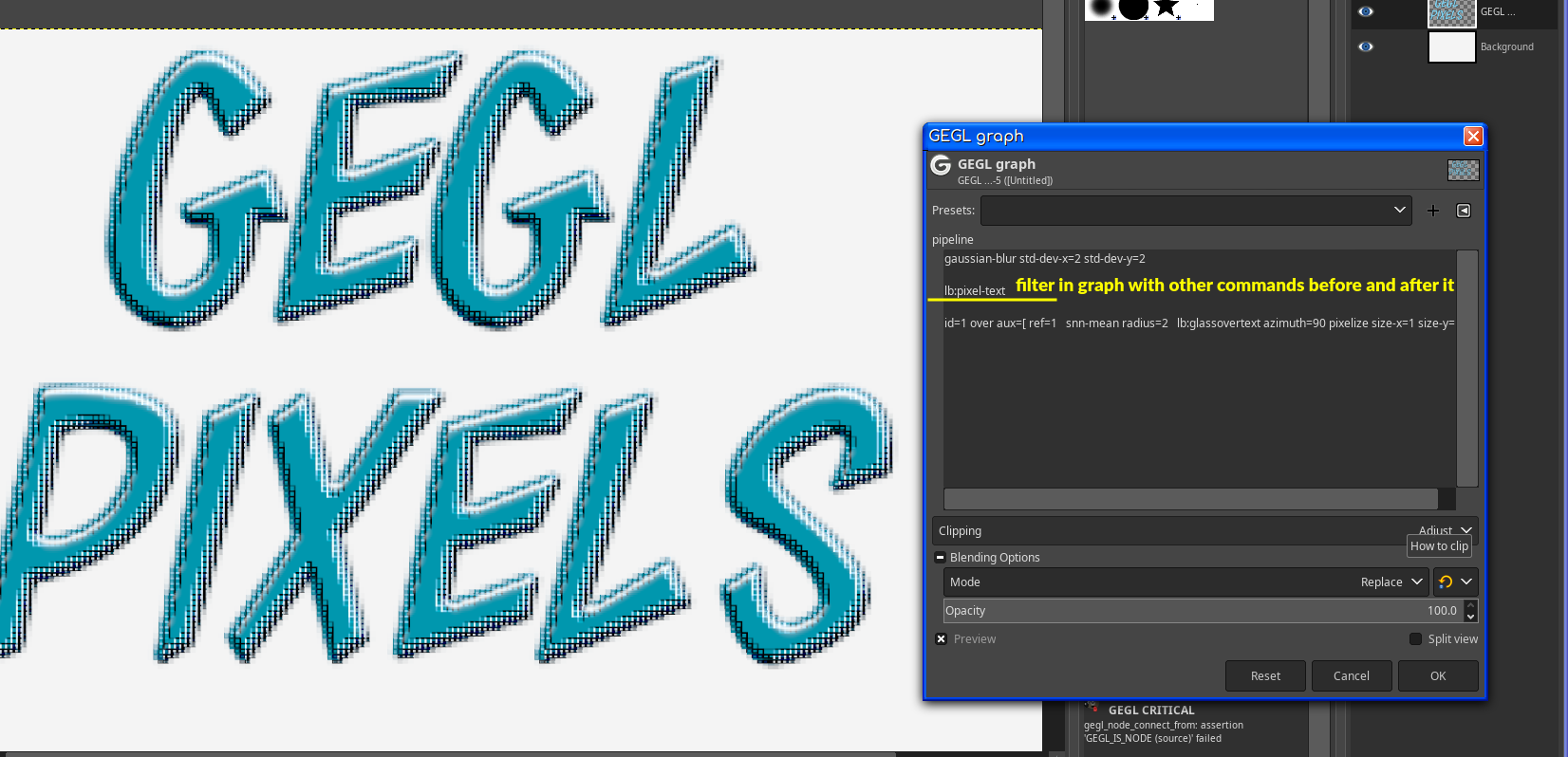

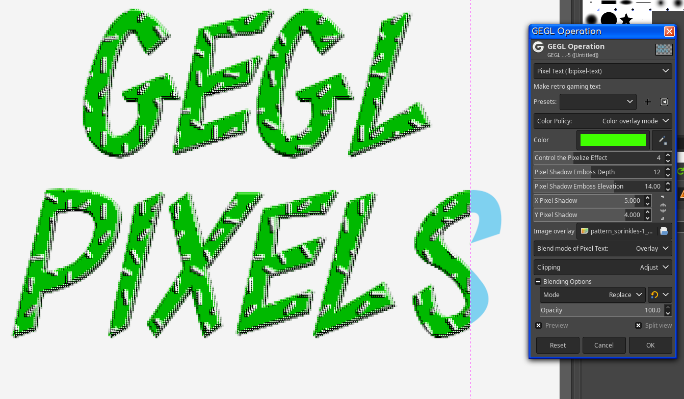

NEW DISCOVERY MADE several minutes ago
A gaussian blur before anything and my "glass over text plugin + gegl:pixelize" after ward creates bettereffect.
Full Code of plugin that is technically complete. Consider this a stable.

/* This is Properties (part 2) where properties are defined
These are sliders to control the pixelize x and y sliders as one.*/
gegl_operation_meta_redirect (operation, "color", state->color, "value");
/* This is where the stateless colorsetting gets swapped for default color mode or any color mode.*/

Pixel text binary downloads on Github have been released. I did not yet add the glass over text or gaussian blur at the start of the graph
https://github.com/LinuxBeaver/Gimp-Pix ... imp_plugin
Everything listed above is documentation of how this plugin was made.
