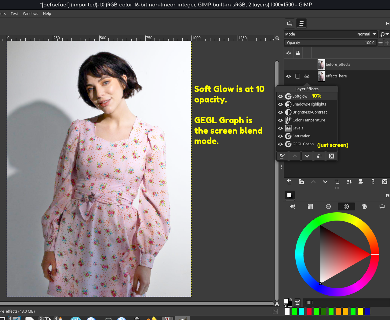

I am using "layer effects" once again
Before non-destructive filters
After non-destructive filters
So yeah, the interesting thing here is GEGL Graph ( a filter that does nothing in default) being set to the "screen" blend mode. So I can use "screen" as a layer effect.

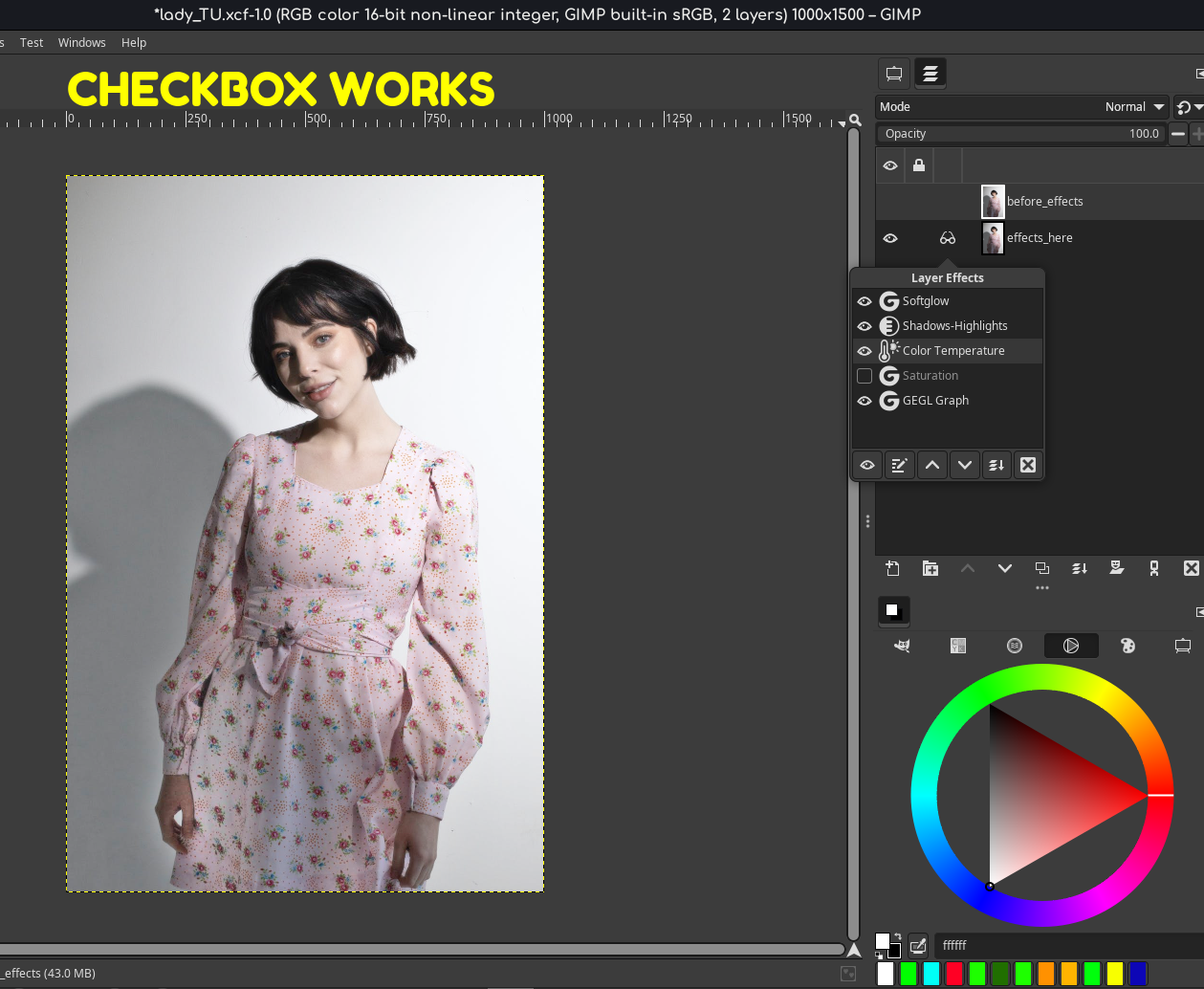

I updated by compiling Gimp and the checkbox works. I am looking forward to future updates.

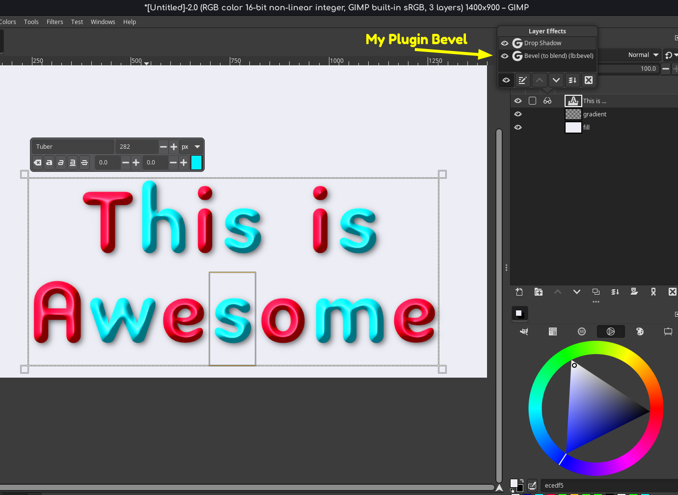

This text updates fast because my bevel plugin is lite. Remember my bevel plugin is an individual component and a dependency of GEGL Effects and can be found here.
https://github.com/LinuxBeaver/Gimp_Lay ... s/releases

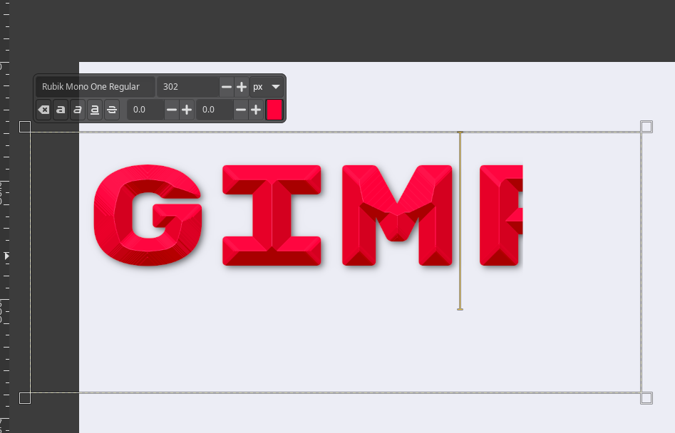

Here is me editing bevel and changing it to its "sharp mode" and making the blend mode "grain merge" where as before I think it was on "hardlight".

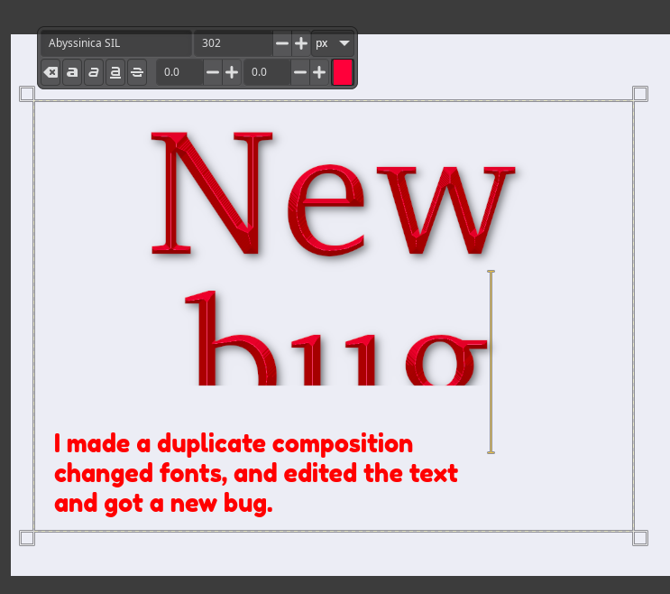

Also, here is another bug for CMYK Student to investigate. This bug literally happened just a few minutes ago while I was making this post. lol

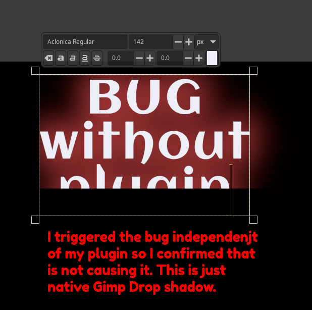

(Ctrl +D) Duplicate a composition which has a text layer with effects and edit it to trigger this bug.
 Post subject: Re: CMYK Student's non-destructive Gimp build in use by me.
PostPosted: Mon Jan 08, 2024 4:15 pm  (#33)
Joined: Oct 31, 2020
Posts: 2025
I confirmed the bug happens even without my plugins

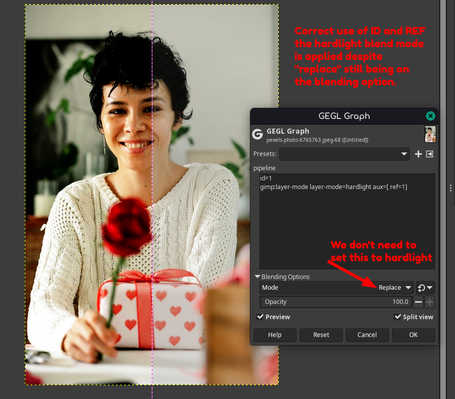

This is not a bug but it is confirming evidence that Gimp is not using GEGL's true node system, as making the first filter a GEGL id; and the second a GEGL ref was a failed task.
In native GEGL syntax id is the bookmark of an image and ref is the call to that bookmark. So if you id the original layer and call it later (with a blend mode) it will blend your composition
Here is a example of it failing in Gimp but succceeding in GEGL Syntax.
id and ref does NOT work in Gimp across effects
Here is an example of id and ref used successful giving an image a hard light blend mode
I would like for this feature to be possible in Gimp's non-destructive editing across layer effects.

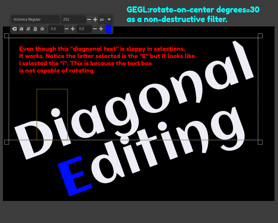

I got diagonal editable text. It works but the text box was never designed to rotate. This was done with the command
gegl:rotate-on-center NOT the Transform tool.

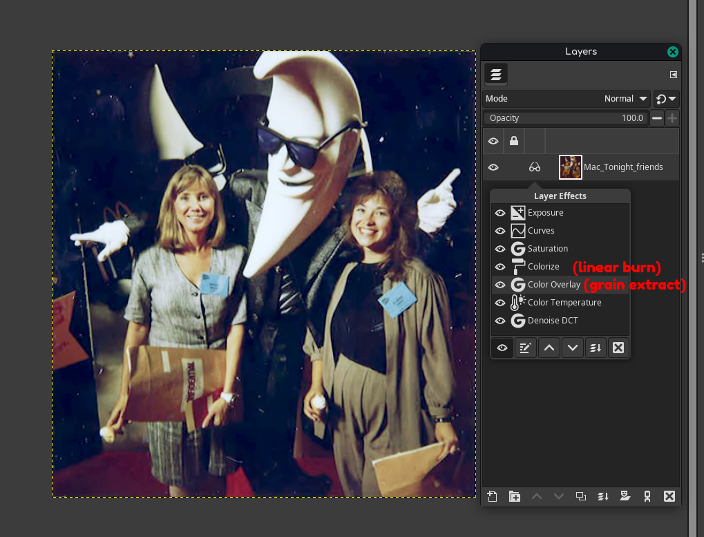

I ran multiple test today and so far everything is good in the neighborhood. (besides the known bugs I reported in the last few days)
In a way this build is semi functional. I can't wait till the next release. I will make it my mission to keep updated with every new release CMYK student does.

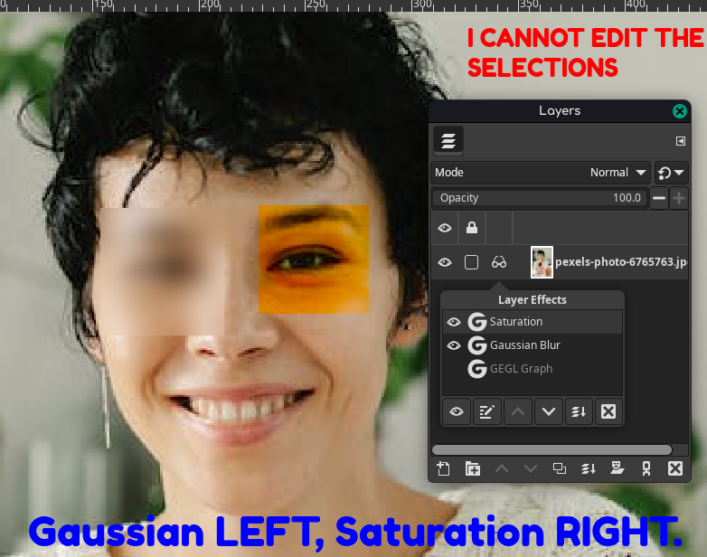

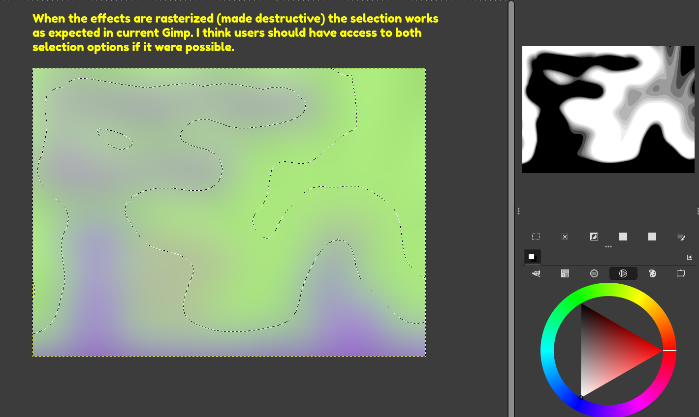

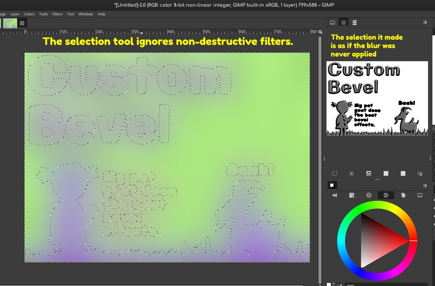

I just learned that the selection tool in this build ignores non-destructive filters. This is somewhat unfortunate because a user may want to use a filter like "edge detect" to make a selection and it will only work if the layer is destructive. In the pics I upload we will see the selection dialog in Gimp entirely ignore the nde gaussian blur.
Original Image
Non destructive Gaussian Blur being entirely ignored by the selection tool
Rasterized (destructive) gaussian blur modifying the selection as expected.
so yeah not really a bug but this behavior wasn't expected and once again making a rasterized copy of the layer with merged effects solves the problem.
