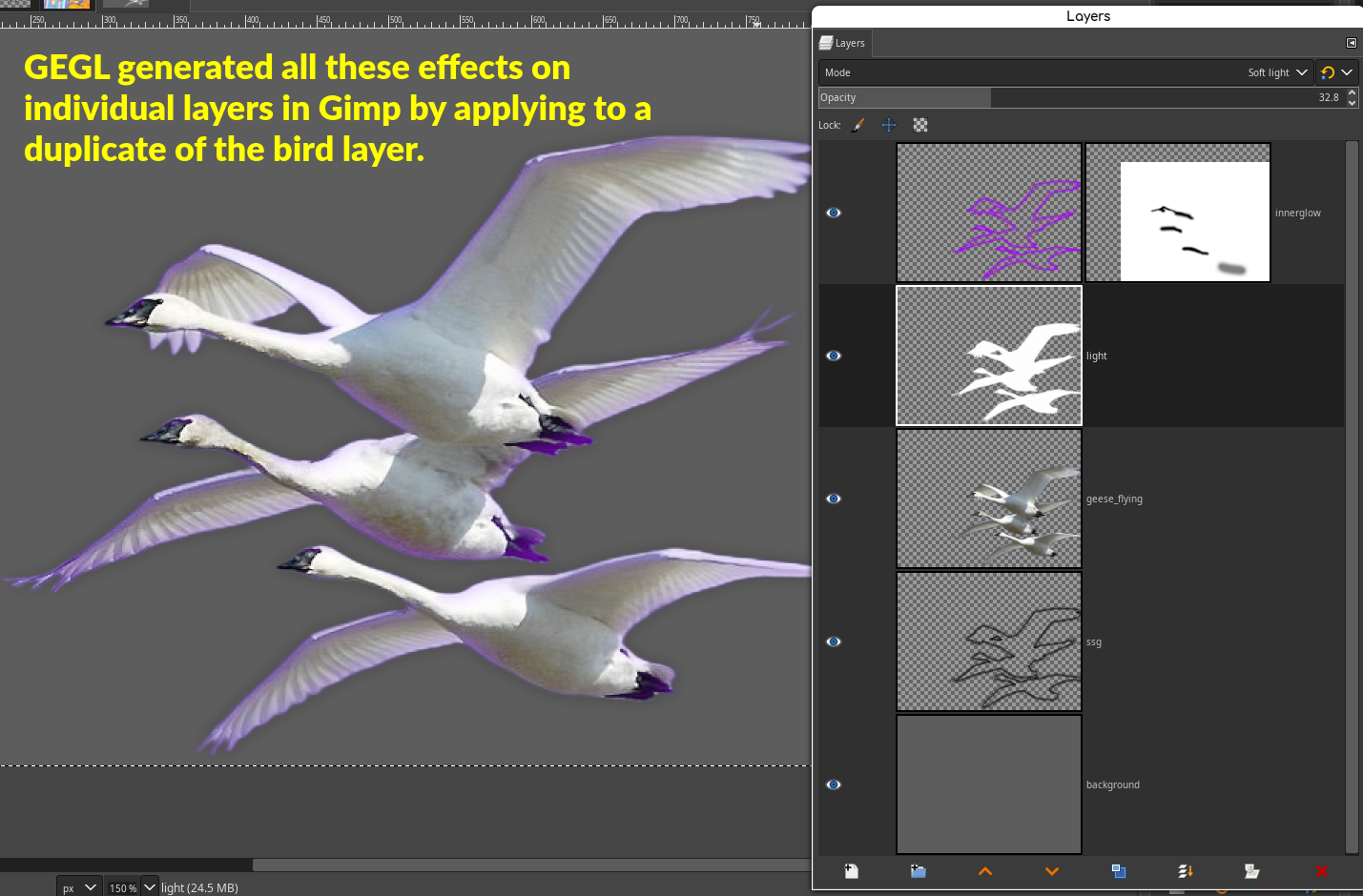

The importance of this thread is paramount. Look how my GEGL plugins are applying on individual layers in Gimp
while fusing with blend modes

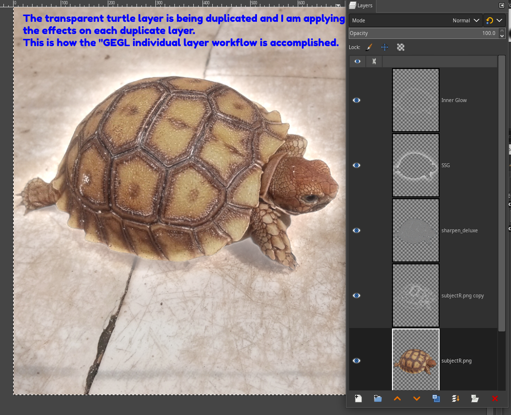

Make a duplicate of a transparent image then apply the effect on the duplicate layer.
Lastly, you can save the transparent turtle composition with blend modes as an .xcf and "open as layers" in another composition inside a layer group set to pass through and it will mimic a "smart object" in Photoshop.

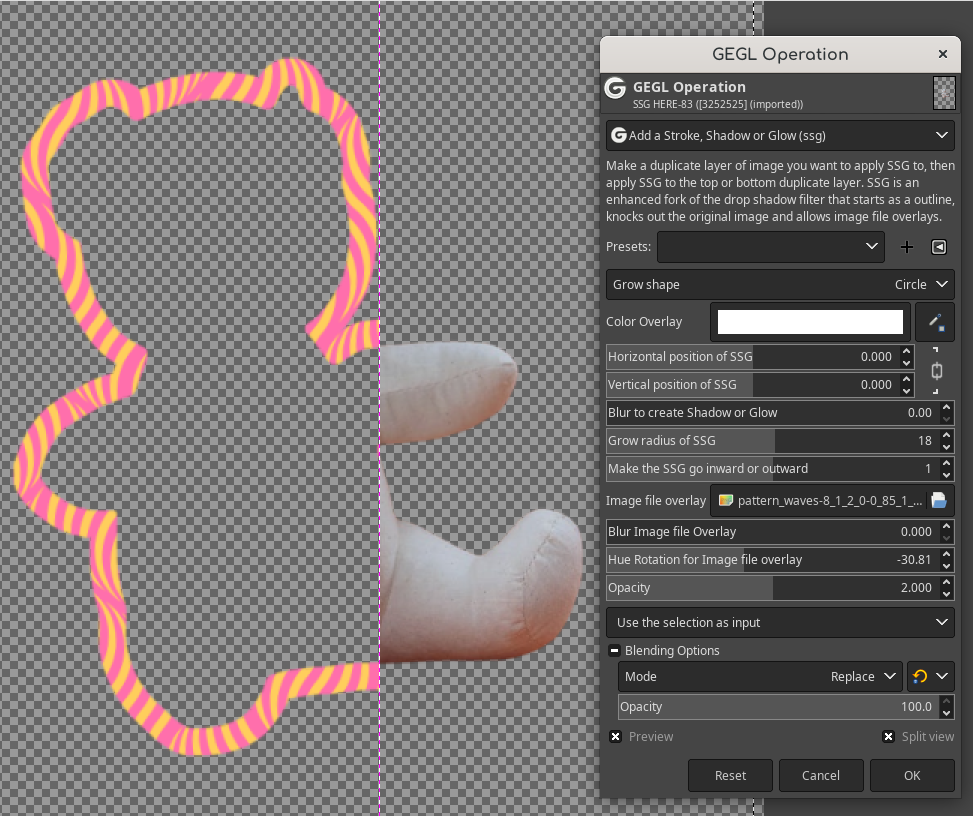

Look what I am doing to a duplicate layer of the bear. I'm making the "outline layer" that goes above the original image of the bear.
