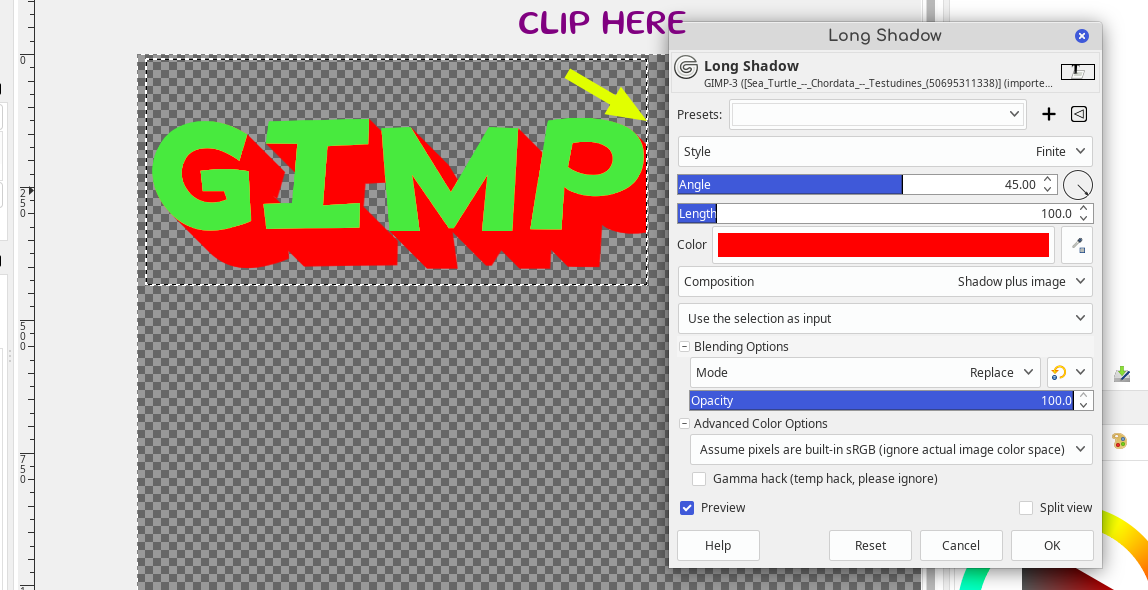

CmykStudent wrote:
contrast_ Hmm? I'm not sure what you mean - I've never had to run "layer to image size" when testing the NDE code. That said, I've focused on applying the built-in filters to text so maybe there's some issue with third-party plug-ins. I can check.
It can be triggered with built in filters like this Long Shadow, but plugins make it even more noticable.
Long Shadow without Layer to Image Size and its clipping
Plugin (GEGL Effects) without Layer to Image Size and its clipping

contrast_ I see. I just tried Long Shadow and it seems to work fine. You can see a video here: https://fosstodon.org/@CmykStudent/111672369103989370
It's probably because with NDE, you can leave the layer as a Text Layer instead of converting it to a raster so there's no issue with clipping.

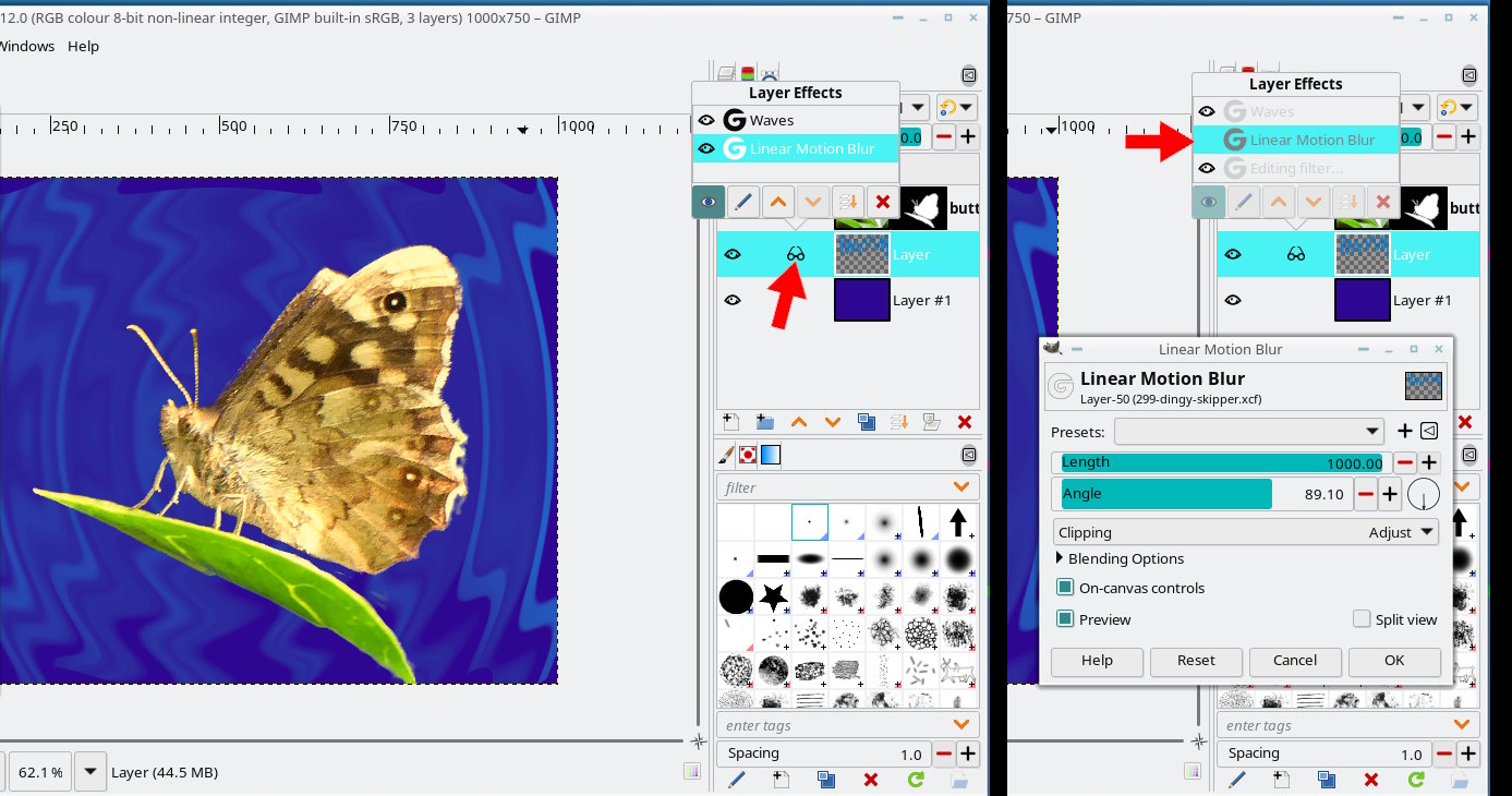

Probably just now with Gimp 2.99.18 it is worth a trial for use, rather than for debugging. CmykStudents code did make it as "Layer Effects" where you can go back and adjust (some-of-the) filters regardless of position. This is a linux appimage, I assume Windows version is available.
One caveat, These .xcf files are not backward compatible with Gimp 2.10 (it does warn you) so no mix-n-match.
When it comes to full time use, I think Gimp 2.10 will be around for a long time. Too many useful old scripts and plugins that will need re-writing (unless AI comes to the rescue). Even then, and this is subjective, some GEGL filters are just not as good as old plugins. Example, Recently, I had to pull out an old Gimp 2.8 ripple plugin, it is just better than the the new one, such is life.
