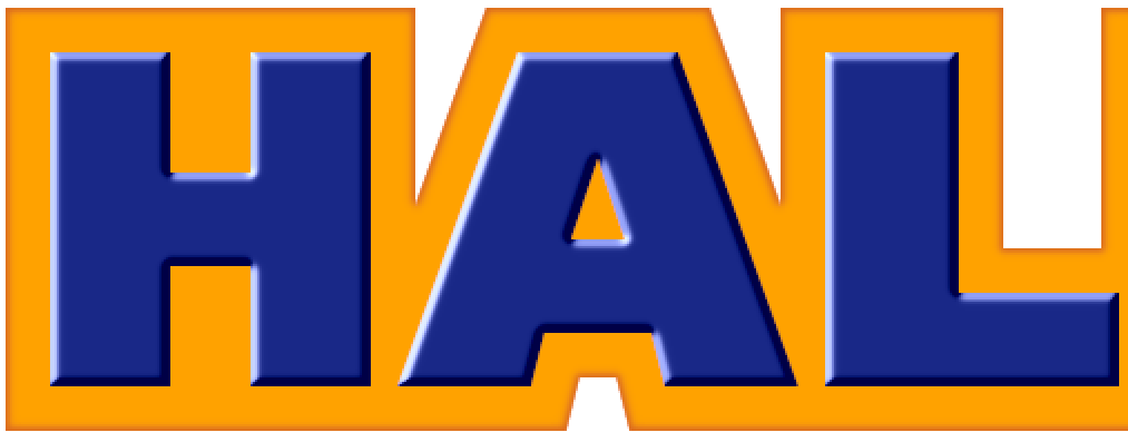

Thanks for the reply! Your preset got me very close to what I needed, and a little tweaking later I was able to get almost exactly what I was looking for. The SSG plugin also helped adding a bit of an outline.
I appreciate the help!!

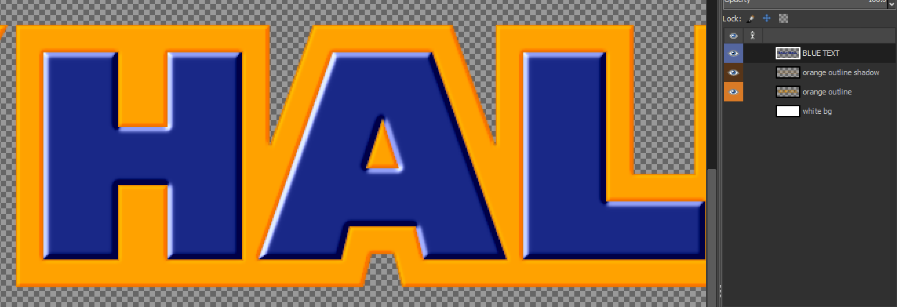

I kept the instructions for how I made the recreation earlier in the thread. I'm not sure if these can be grouped together into like one script or anything as it's a very manual process, but it was close enough for me.
##### create blue text
NiseSegaSonic 192px font, color #192887
adjust individual character kerning until satisfied
duplicate the text layer for safe keeping
hide the original and select the duplicate text layer
##### create orange outline
right click new text layer > text to path
create a new transparent layer above the text layer
shift + Q to enable quickmask
select white as your active foreground color
edit > stroke path
Line, Foreground color, Antialiasing enabled, Line width 40.0
Stroke the line
shift + Q to disable quickmask
have the transparent layer selected if it isnt already
select > remove holes
fill selection with sonic orange color #FFA200
move outline layer underneath text layer
ctrl+shift+a or select > none to remove selection
##### bevel the blue text
right click the text layer > layer to image size
make sure the text layer is selected
tools > GEGL Operation
select drop box, select Bevel (to blend) (lb:bevel)
Normal Bevel
Radius Normal Bevel 1
Radius Box Bevel 1
Depth Angle 12.40
Depth 100
Bevel's Coverage Threshold 0.1
Rotate Lighting 145
Black Bevel Mode 0
Blending Options Mode: Linear Light
Opacity 65
by the Presets box, click the + button and name this preset something like "Sonic Blue Text Inner Bevel" to save the settings
click OK to apply the bevel filter
##### bevel the orange outline
right click the blue text layer > alpha to selection
select the orange outline layer
duplicate it, then hide the original
delete the selection on the orange outline layer
duplicate the layer again, hide the original
select > none
select the top orange layer
tools > GEGL Operation > Bevel (to blend) (lb:bevel)
Normal Bevel
Radius Normal bevel 0.5
Radius Box Bevel 2
Depth Angle 12.40
Depth 1
Rotate Lighting 145
Black Bevel 0
Blending Options Mode: Soft Light
Opacity 100
Save and name this as a preset by clicking the + button by the presets box at the top
click OK
select the layer underneath the one currently selected, the orange outline with the cutout inside
move it above the layer you just beveled and show the layer
tools > GEGL Operation > Add a Stroke, Shadow, or Glow
Grow Shape: Circle
Color Overlay #db6604
Horizontal and Vertical Position 0.000
Blur to create Shadow 0.50
Grow radius of SSG 1
Make the SSG inward or outward 1
Image file overlay None
Blue Image file Overlay 0
Hue Rotation for Image file overlay 0
Opacity 2.000
Blending Options Mode Replace
Opacity 80
Save and name this preset
click OK
##### should be complete, verify layers are correctly ordered
1. Blue Text with bevel applied
2. Orange outline with shadow
3. Orange outline with bevel applied

I tried to create this look using the original image and came pretty close,
by filling selections, moving them around a bit and using various layer modes.
File comment: My example image
Wallace_969acd75-b08e-4a9f-a385-64b791fa793c-1145634357.png [ 165.08 KiB | Viewed 2244 times ]
The bevel I added to the text was created by making selections inverting them,
and filling the inverted selection with a light color.
Gaussian Blur of 18 was used on this layer.
Color curves was used set to alpha to refine the bevel.
Set this layers mode to addition and reposition it as desired.
My final step was to make a selection of the blue text,
invert it and use this selection to remove the unnecessary outer portion of the bevel layers.
The same was done for the large orange text padding,
but with a dark color use for the bevel.
