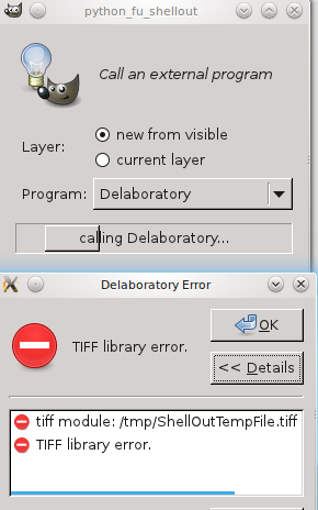

Did someone succeeded in using ShellOut ?
I have only so many mistakes.
["Delaboratory", "\"/usr/local/bin/delaboratory\"", "png"] - Error
["Delaboratory", "\"/usr/local/bin/delaboratory\"", "tiff"] - Error

 Post subject: Re: Delaboratory
PostPosted: Thu Jun 02, 2011 5:25 am  (#4)
Joined: Jun 02, 2011
Posts: 58
Hello,
Thanks for announcing it here :)
(I wasn't aware of this forum, announced it only on flickr and gimp talk).
I never used shellout, is it a way to call delaboratory from GIMP itself?
I will try to fix the problem when I will be able to repeat your steps.
The png won't work for sure, the tiff may be problematic if it has 4 channels instead 3 (it's already fixed on SVN).
PhotoComix you can't scale curves window, curves editor is not finished as you can see, but I really have no idea how scaling should work, because size of the curves panel is fixed (this is related to the way I store curve), the only solution I see is to define size of panel as 1000 and then downscale it to 500, 250, etc...

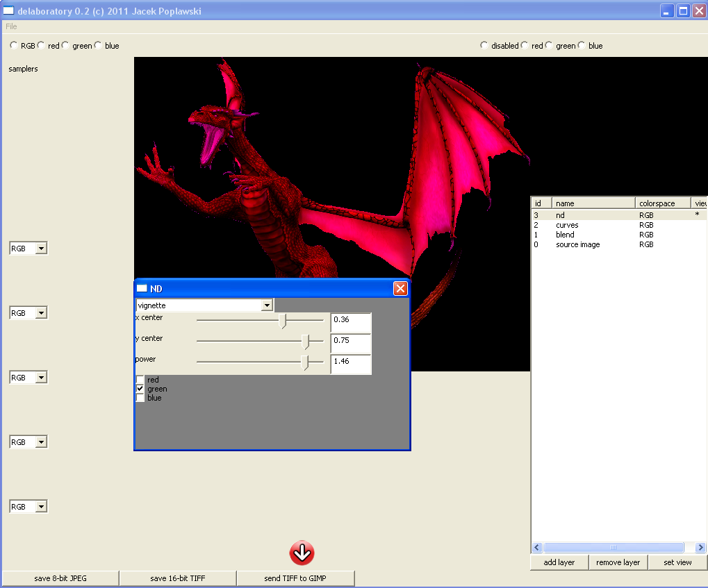

PostPosted: Wed Jun 08, 2011 4:30 pm  (#6)
Posts: 58
delaboratory 0.2 has been released
- Blur layer
- ND layer
- GUI improvements and bugfixes

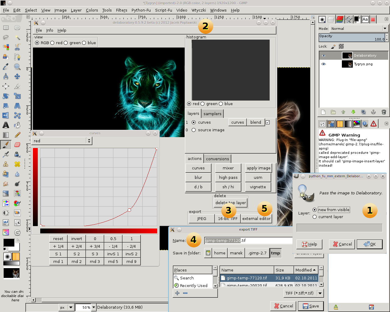

PostPosted: Fri Feb 03, 2012 11:49 am  (#10)
If anyone is interested this is the solution of the problem:
to call Delabolatory (0.5.9.2 beta ) in GIMP menu - adapted from an earlier version of Michael Munzert'a plugin Python (written for Photivo)
Limitation for Windows: Delabolatory not be in a directory whose name contains spaces - as default location C: \ Program Files \ Delabolatory change such as c: \ Delabolatory.
Delabolatory correct path to the program is part of the line 67 [path] - edit: opening plugin in a text editor (preferably Notepad + +).
Two versions of the plug: for Windows (Export this Delaboratory Win.zip) and Linux (Export this Delaboratory Linux.py.tar.bz2) in annex.
