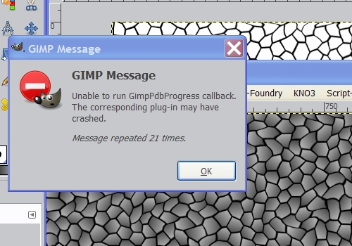

I couldn't get the Voronoi render to work right so I just used Mosaic to get a pattern. I ran the mulifill script and it did take a while and it seemd to work ok, but when it finished I got this error. Any clues?
That errors seems to have started popping up with gimp 2.6.11
Another script I wrote also does that...It doesn't seem to effect operation though.
-Rob A>

RobA wrote:
-Rob A>
