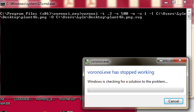

Cool Sahab; very much enjoy your gift and glad that you shared it with us. Yeah, I get this crash on a test image that I used with the current release (and not all images crash mind you). Also seems much slower then the release that I downloaded this past November (though on that image it does work; not showing the result). Event viewer didn't flag anything either so the error just remains vague unfortunately. :)
Below's my batch file that I do a drag and drop from a shortcut that's on my desktop:
voronoi -t .3 -s 500 -n -z 1 -I %1 -O %1.svg
Below is the crash; no description (trust me I waited long enough and just stopped the wait):
I used Adrian's plant4h.png and it crashes every time (even my other batch file which uses 5000 stipples instead of 500 but identical to the batch file posted otherwise). Not sure if it will crash for you. It's a greyscale image; I even tried to convert it to rgb but it still crashes. :)
Link to Adrian's test images: http://www.mrl.nyu.edu/~ajsecord/npar20 ... ginals.zip

I've filed this as Issue #18: (https://github.com/thegrandpoobah/voronoi/issues/18) and will take a look sometime soon-ish.
It may be related to Issue #17 (https://github.com/thegrandpoobah/voronoi/issues/17), which I have a potential fix for that I am testing.
(For future consideration, if you use the -l (logging) option, it sometimes gives more insight into where/why it crashed, but I don't think that in this particular case it makes any difference.

I was able to reproduce the problem and I think I have a fix. Please try out this version which contains the fix: http://www.saliences.com/downloads/stip ... t-beta.zip
and let me know if it works out.
As for the speed issues, although the tool may be slower by default on smaller number of stipples, it now scales much better than before. For example, on my own laptop it would have been basically impossible to generate images with 10,000+ stipples in the past, but now I can comfortably do images with 100,000+ stipples and/or lower (more accurate) threshold settings.
For smaller number of stipples (or gigantic images), you can make the tool faster without sacrificing quality by decreasing the sub-pixel density setting (-p 1 is a good start).
All of this should *really* be documented, but alas, who has the patience :)
