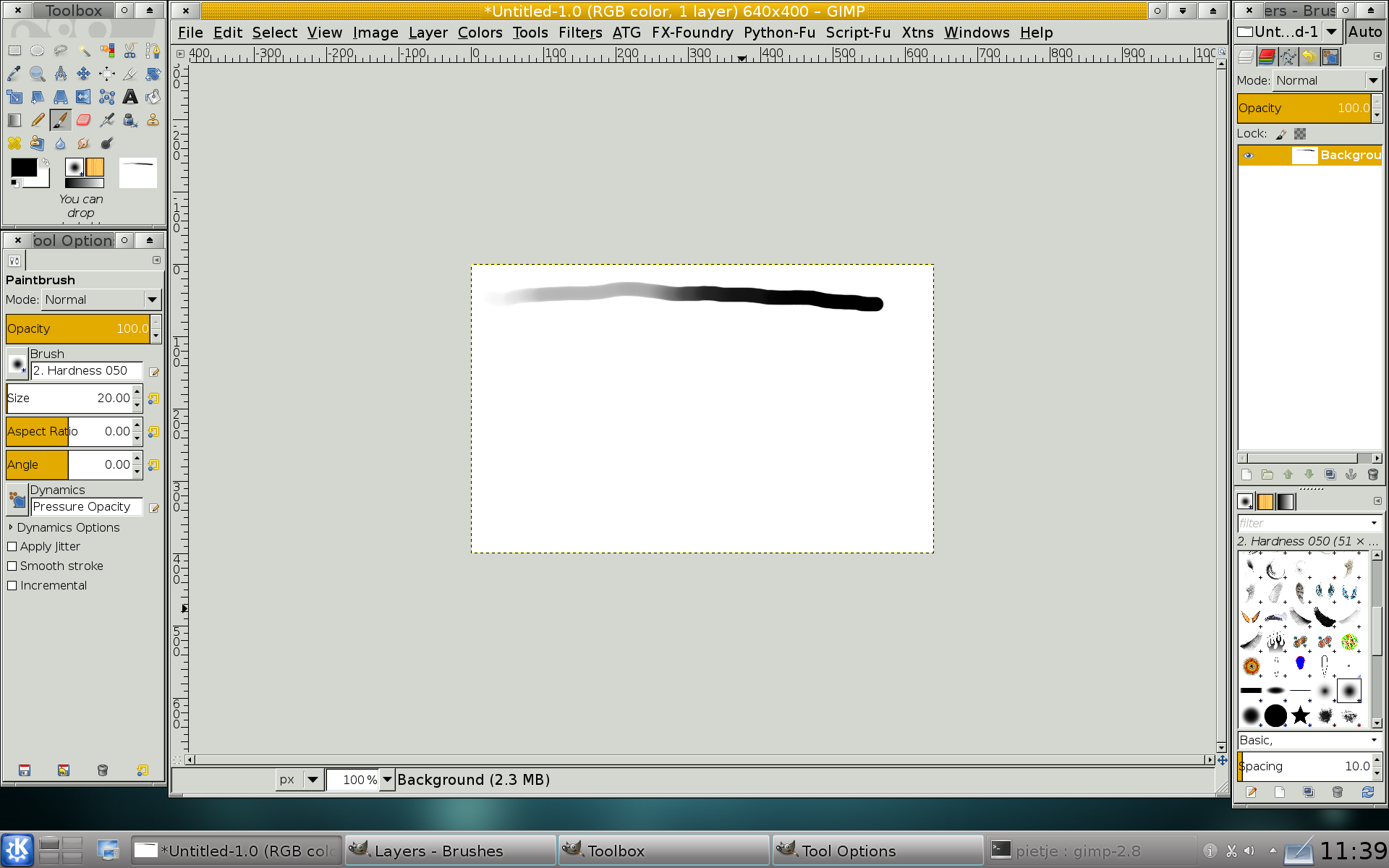

Grant_M,
I installed 2.8 on a separate install of Gentoo Linux.
I have a Wacom BambooPT 2FG 4x5 tablet.
My gimp-2.8.0 was installed with the gtk+-2.24.10-r1 library.
As you can see from the screenshot it works ok.
