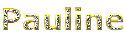

PostPosted: Mon Jun 11, 2012 7:44 am  (#8)
Joined: Apr 09, 2011
Posts: 1764
Mine turned out ok too
