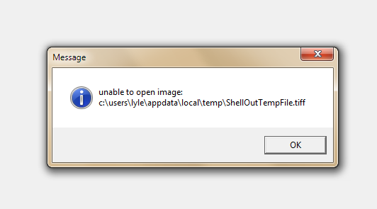

Thanks for pointing that out MareroQ; I, indeed, had version .4 and needed version .5 but now I get this error with Delaboratory (and even after opening a tif file like Rod outlined). :)

Just to add, I did open the resulting tif file in Irfanview and, despite the .tiff extention, Irfanview said that it is still a PNG file and additionally asked if I want to save it as a PNG. So the problem is somehow still with how shellout exports file type. :)

Great Rob. Delaboratory 0.7.3.1, Gimp 2.8 and Vista32 works both ways using ShellOut :yes
I'm still having a problem sending to Gimp 2.8 from Delaboratory 0.7.3.1, if I first open an image in Delaboratory, so I'll not do that again unless anyone has any ideas? The following error message comes up in Delaboratory trying to send, jpg, tiff and raw. The only difference in the error messages is the file name, the extension is always .tiff.
File comment: Delaboratory Error
