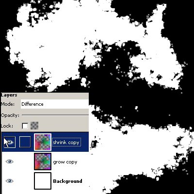

Hi ofnuts , there is probably very little difference in this case . This is a small and simple image. It is just the way I work , I try to keep the focus on the thing to be altered (the image). Absolutely nothing wrong if you want to do the grow method. But there is a difference I believe in the way that Gimp handles single pixel outlines. If you use the same image and use the shrink and grow methods and overlay them in difference mode you can see the difference. In this case almost unnoticeable, but if you use the different methods in a complex image such as a plasma render the difference is quite noticeable. I came across this effect some time ago when I had unexplained dots of colours in an image. I do not know what causes this discrepancy but I believe it is probably a rounding error somewhere in the pixel maths. Nor do I know which method is the correct outcome of the maths. I suppose both methods are correct depending on your needs.
The difference in the first image is the white outline, the difference in the plasma is the grey dots
 Post subject: Re: How to Change the Background of This Logo
PostPosted: Tue Aug 07, 2012 6:06 am  (#9)
Very good example wbool.
Because you should not do it that way, you are destroying the anti-aliasing pixels. See here for an explanation.
