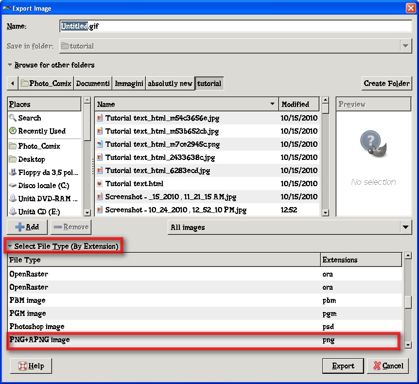

And i forgot to add that is possible also save with much higher quality then with gif as apng (animated png , FF and Opera display them well not sure for IE
and advice that the apng plugin is tricky:
if you just try to save something as image.apng will pop up a warning about apng be "unknow file type" save will fail and you may think the apng plugin doesn't work
BUT IT WORKS:only you have to expand a almost hidden dropdown list in the save dialog..look here

there quite hidden in the lower part of the menu the voice to click on to successfully save as apng

Thanks,Thanks PC today I did it to try. SWF-Export works on Win-XP SP-3.5. :yes Hmmmm, how to open swf in the GIMP? ImageImage

about swf...for sure gimp with the swf plugin may export in that format ..i am not sure about reading.
