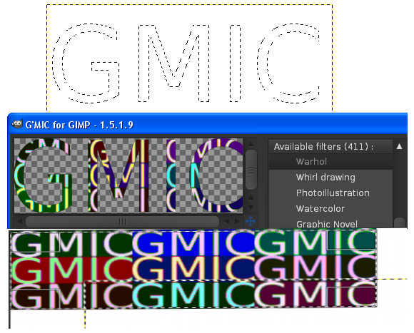

This is strange - so interesting.
Is GMIC supports alpha channel? It seems that they do not - and if so - in what way?
The first case - other than the result preview !

sallyanne: i thought that would happen, and it happened to me when i made that text too, so i wrote the workaround into my tutorial. look at step 4 again, i've highlighted the important parts:
AnMal wrote:
4. now comes the tricky part, since the filter is a bit capricious. if you're lucky, the outcome is your text selection with the new text in text. in that case, just leave it as it is and pick up at step 8. but most of the time you're just not that lucky, and you get a rectangle with text in it - then you will have to do some extra work. to begin with, you need to have that rectangle in a separate layer from your original text. if it's not, just undo and go back go g'mic -> warhol. in the left side of the g'mic menu you can go to the "output" box and choose "new layer(s)" from the drop down menu. then just do the same things as in step 3 and you will have a rectangle in a separate layer from your original text.
the "rectangle with text in it" is exactly the same as your "tiled boxes of text". you need to follow step 4 closely and then you should be able to make it :). good luck!
