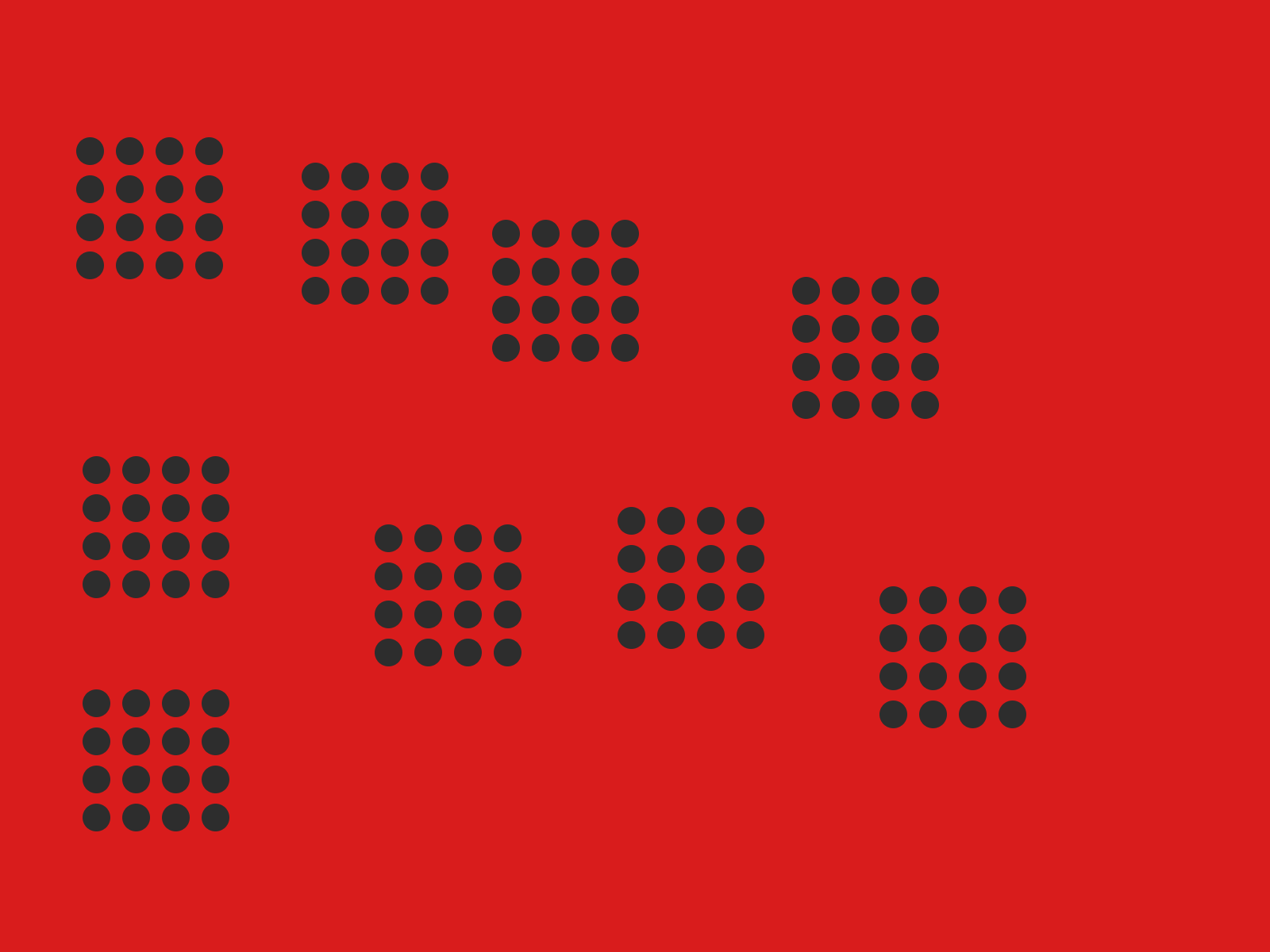

I made a dot brush and named it Dots.gbr. I made it on a transparent layer and it is grayscale. It turned out to be a square brush and I don't want that. I just want the dots. How do I change it to that...HELP Please

Transparent, grayscale, IFAIK its going to be square
Ahh.... maybe look at the spacing, default 10 makes it very solid

I changed the spacing to 100 and it is still square.

I still got the square...dam

worked for me

:oops: Thanks Esper, I must have been using a different tutorial. Could you post the one you used. I did it over again and mine still has a square around it. Yours works great. :gaah :hoh

The brush is the whole image. If you want only one dot then your brush image should only have one dot. But it looks like what you want would be easier done with a "parametric" brush (those defined by shape/spikes/radius/aspect ratio) with a sufficient spacing.
If the image is in grayscale mode (and not just grayscale in RGB mode), the white corresponds to transparency and the black is the foreground color (so your brush can be colored).
as i said before (and learned from malgalin):
Image Mode: grayscale
white BG layer
create one dot with a (black) filled selection and then clone layer tool for the other dots
merge down
export as gbr
 Post subject: Re: gbr brush
PostPosted: Tue Jan 22, 2013 7:04 pm  (#16)
It still ends up as a square though Esper.
This is what I was trying to avoid. I have brushes in my folder that are quite similar and they aren't in squares and I think ofnuts explained it but I don't know if I can do what he said or notl

The brush has to be flattened Molly (ie. one layer and no alpha channel) I believe it is Image>flatten image.

Still can't see the problem but maybe we are talking about different things.
A very quick video - 2.5 mins - going back to the earlier posts
http://youtu.be/OxY2UhKEr3E
where do you differ?

Ok, first of all, that was a very nice mini-tute you did and you have a very nice clear speaking voice...thank you
What you did was very clear and I understand it well, now is there any way I can make them without being square? More scattered the way it shows these other brushes in the screen shot below. One of them is bristles 2 and bristles 3
EDIT: Silly me, I finally got it. I just staggered the dots to get what I want. thanks Rich and everyone else too.
dots pattern staggered in attachment below
dots.gbr [39.09 KiB]
