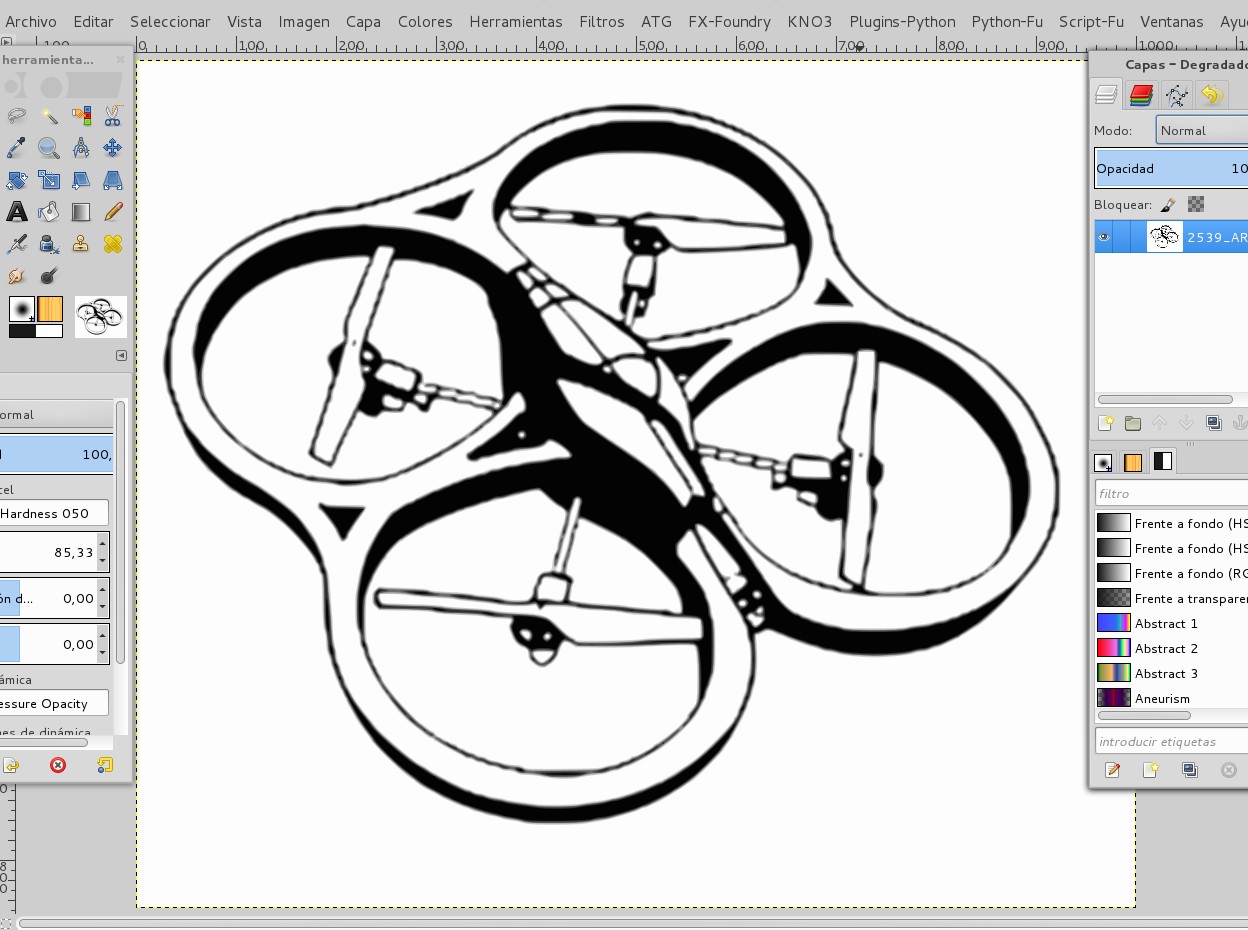

How to did you scale up the pic?.
This is a redraw with inkscape, tracing the bitmap, save as *.svg and upload in Gimp

@jamac4k : I used a plugin called upsize to scale it uphttp://registry.gimp.org/node/19582 Wow your result is impressive!
