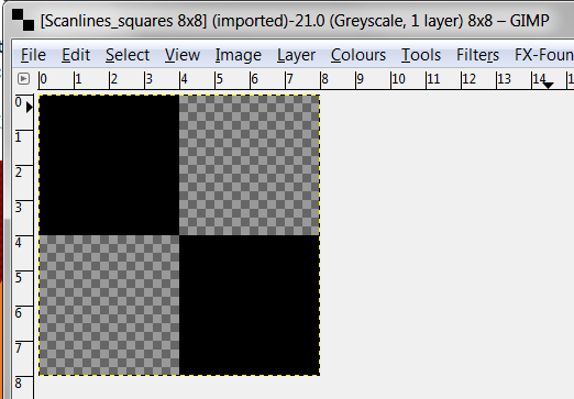

Here is how i made the grungy background text:
First i wanted to add some plates to the BG in a creamy color with orange, but that was too much with the red....
The BG is red #a10000 with square scanlines 8x8 on 'Grain Merge' mode 23%.
