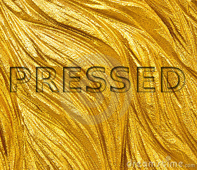

How can I create pressed and embossed text like this http://blog.entheosweb.com/wp-content/uploads/2012/02/pressed-and-embossed-styles.jpg
I want these effects on the following golden background.

In my opinion, the best "pressed" effect is a slightly offset inner shadow. You can almost get away with performing a drop shadow on the inverted selection of the text, but the following approach provides a bit more control.
  • Create your text in black.
  • Perform "Alpha to Selection"
  • Perform "Shrink Selection" by a couple pixels.
  • Add a layermask initialized to "Transfer Layer's Alpha Channel" (your text layer should be all black afterward).
  • Activate your text layer and then perform an "Edit->Clear".
  • Perform a "Mask to Selection".
  • Delete your layermask.
  • Perform a Gaussian blur of a few pixels.
  • Use the Move Tool to move your text layer down and to the right (by half the amount you originally shrunk your selection by).
  • Invert your selection.
  • "Edit->Clear".
  • (optionally) lower the opacity of the text layer.

So I've followed the basic of the bump map idea just inverted the colours for the pressed text.
Then added the internal drop shadow for the pressed text and the external shadow for the embossed text.
Finally just to enhance the effect I made the colour of the inside of the text, not the bumped part, slightly darker than the main colour of the image for the pressed text and slightly lightly for the embossed text.
And with the provided texture, did create a grey scale image of text and displace the texture.
