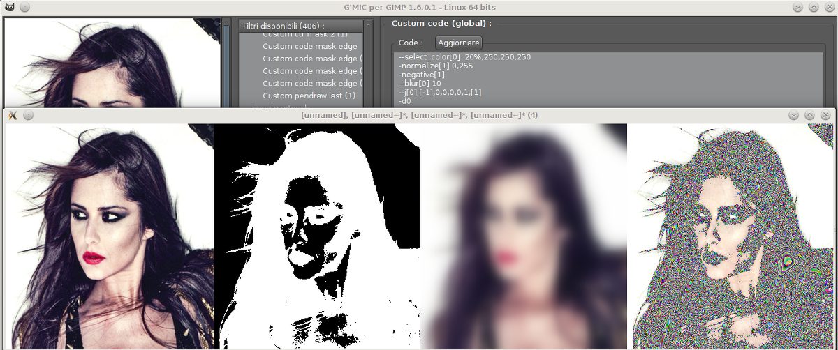

Some bugs?

Ok, found the solution.
Now how to use the mask [1] to apply a command/filter to [0] only in white [1] areas?
I search "mask" "alpha" in reference.shtml but nothing help me ...
Thank's.

The general idea to do that, is to apply the effect on the whole image, then copy only the masked part of the result to the initial image [0].
Example, with a blur, you can add this to your G'MIC command to do the trick.
--blur[0] 10 -j[0] [-1],0,0,0,0,1,[1] -rm[-1]

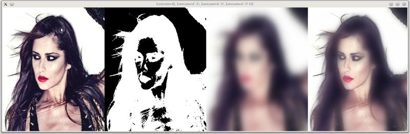

I found this solution that seems to work
--select_color[0]  20%,250,250,250
-normalize[1] 0,255
-negative[1]
--append[0,1] c
#-drgba
-b[2] 16
--blend[0,2] alpha,1
-remove_opacity[3]
-d0

Because in that case, you don't have to normalize the mask image in [0,255].
The values can be left in [0,1].

Same result, but with fewer steps needed:
