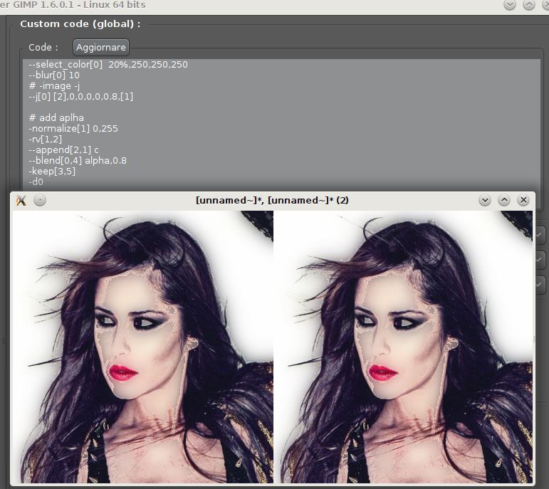

Same result, but with fewer steps needed:

I did some test,
a flou/soft focus filter with edges protection
the "mask" is --gimp_gradient_norm[0]
with RGBA and -blend alpha works as expected:
instead with -j the result is bad:
so I wrote the filter using the first method.
Any advice?
Thanks.
 Post subject: Re: G'MIC command like "gimp-by-color-select" ?
PostPosted: Thu Oct 16, 2014 2:40 am  (#12)
Joined: Jan 03, 2011
Posts: 1656
The method with '-j' assumes that your mask has values in [0,1].
For different values, you can expect weird pixels appearing. Have you checked this is indeed the case ?
PostPosted: Thu Oct 16, 2014 6:12 am  (#14)
Posts: 1656
No, -j also works with smooth masks. But the mask values must be kept in the [0,1] interval.
PostPosted: Fri Oct 17, 2014 10:48 am  (#15)
Joined: Oct 11, 2014
Posts: 82
ok this is a test
Mask255 [1] is a 0,255 16 level mask.
--normalize[1] 0,1
should reduce the interval in [0,1] range in new image [3]
but the result is bad ...
I suppose that the pixels of the mask should have a value of 0 or 1 (sharp mask),
not 0 ... 0.2 ... 0.8 ... 1 (soft).
Or something wrong?
