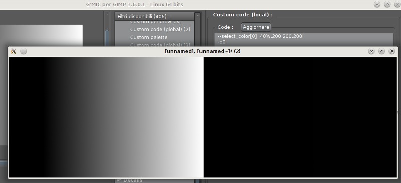

Some bugs?

Ok, found the solution.
Now how to use the mask [1] to apply a command/filter to [0] only in white [1] areas?
I search "mask" "alpha" in reference.shtml but nothing help me ...
Thank's.

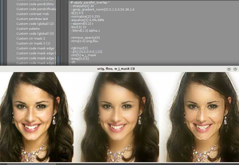

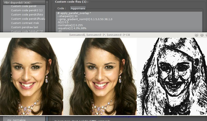

I did some test,
a flou/soft focus filter with edges protection
the "mask" is --gimp_gradient_norm[0]
with RGBA and -blend alpha works as expected:
instead with -j the result is bad:
so I wrote the filter using the first method.
Any advice?
Thanks.

The method with '-j' assumes that your mask has values in [0,1].
For different values, you can expect weird pixels appearing. Have you checked this is indeed the case ?

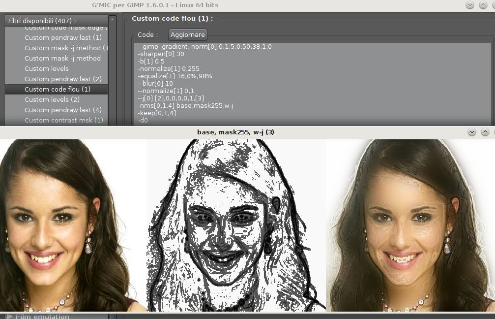

ok this is a test
Mask255 [1] is a 0,255 16 level mask.
--normalize[1] 0,1
should reduce the interval in [0,1] range in new image [3]
but the result is bad ...
I suppose that the pixels of the mask should have a value of 0 or 1 (sharp mask),
not 0 ... 0.2 ... 0.8 ... 1 (soft).
Or something wrong?
