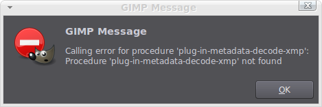

I managed to compile - I think that's the right term - the new version of Gimp from a tarball.It wasn't available via synaptic for my OS, Linux Mint 15, and I was a bit dubious about using the PPA I was looking at as there was a big red cross in the left corner of my FireFox browser that looked to all the world as if it was a big don't use sign, or maybe I'm just being overly cautious.
Anyway, I complied it, first time I've ever done anything like that so I was pretty pleased, but now I get this message when I open certain files,Image

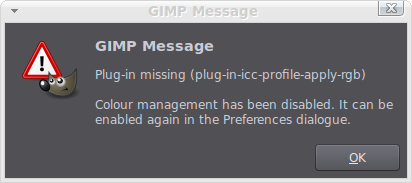

So, I know I need the plug-in mentioned but I haven't been able to find it yet, and I'm not sure whether it should go in my users folder or else where.
Also, although I have the help files installed, synaptic tells me they are, Gimp preferences states that there are no local help files installed.
And finally, when I click the close window cross at the top right hand side Gimp wants to shut down all the open images. A warning comes up saying that all the images will be closed so it's not a surprise but in the last version clicking the right hand corner cross used to shut the open images one at a time, and when the final image was closed Gimp would stay open with no image loaded, but now as soon as the final image is closed Gimp shuts down. I don't know if this new behaviour is the default for the 2.8.6 version or if it can be switch back to behave the way 2.8.4 did.
Apart from these few things everything else seems okay.
If anyone has any pointers on how to solve these problems it will be much appreciated.

color profile can be set here - Edit>Preferences>Color Management

The one you need for colour management is the little cms one, and webkitgtk is the one that is needed for the help browser.

The plug-in you are missing is the plug-in lcms (I think in linux without extension) and is compiled, if the library 'little-cms', as mentioned above, is present. You need the version 1.19 for gimp-2.8.x, the 2.xx version of little-cms is not recognized by gimp-2.8.x.
Can you disable color management in preferences so that error does not occur? Or does it come, whatever you do?

It's pretty clear now that I've made a fair few mistakes when compiling Gimp. I only added the dependences that where listed after I ran ./configure, the ones that the script said where needed. None that where option, and not asked for, where added, so I'm going to guess that that's where my main problem lies.
I can't find the package libicms-dev listed in synaptic so it's unlikely that I installed it.
I have 'liblcms1 1.19' and 'liblcms2-2 2.4' installed but not 'liblcms1-dev'. I'm not sure if I should remove 2.4 version?
webkitgtk is install but not dev package for it.
Once colour management is disabled in preferences then the error message no longer appears, but I have now found that I get a new error message when i open certain images.

No, you need not to deinstall lcms2. but you need lcms1-dev
For the last error you need libexif, always the dev-version.
The usual way to test, if you have a special library is with pkg-config. Therefore you need a
libblabla.pc in pkg-config - folder. This .pc is only included in the dev version of the library. There are
of course, some other things in the dev version.

Thanks, Onkel Hattl, libexif fixed the latest error.

Performing 'which gimp' in the terminal will instruct as to where gimp has been installed. If it has been installed in /usr/local/bin then it is a version you've previously built from source (and thus your package manager knows not of its existence).
To remove such an install, run the following as root in your build directory:
./configure --prefix=/usr/local/bin
make uninstall
You should then build your new version using a prefix of /usr/bin

Here's a suggestion that is worth considering for anyone who likes to roll their own binaries:
First run sudo make uninstall in your source directory. This will remove the old version of gimp.
Then, run sudo apt-get install checkinstall
Then, compile gimp again, but this time, instead of the "sudo make install" step, just substitute it with sudo checkinstall, follow the instructions, and it will be the same as make install BUT additionally, it will wrap the installed files in a .deb package, which means you can easily remove gimp later on with dpkg, apt or synaptic.
(Also remember the correct order is make first, then make install/checkinstall)

I found where Gimp was hiding by using the 'which gimp' command in terminal then removed it, compiled again and installed using the instructions provided by dd which worked a charm. And best of all it's listed in synaptic which in my opinion is very cool.
All the error messages are now gone and the manual and help files use Gimp's own browser.
Not come across any other problems so far but there were a few libraries that I couldn't find before compiling, the ones for compressor spring to mind, so I'll have to see if any other problems crop up further down the road, but at least I know that I'm on the right track now.
