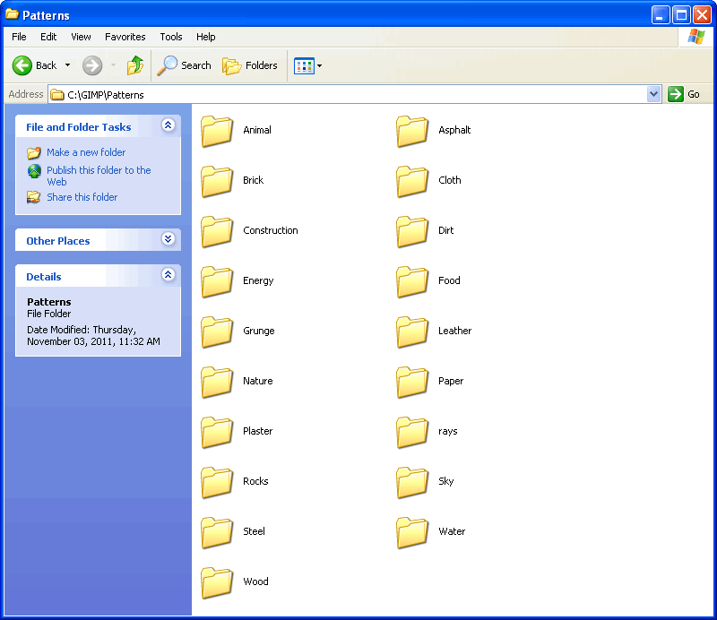

Side note: Patterns how do you guys break down your patterns? Do you just leave them in a folder named from the source that they came from? Or .. some other scheme! I guess gradients too! :)
 Post subject: Re: Can't get GURM to work
PostPosted: Mon Dec 05, 2011 2:18 pm  (#29)
Posts: 16256
Here are my pattern folders -

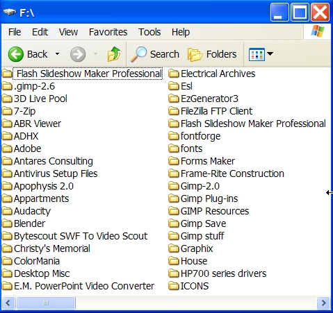

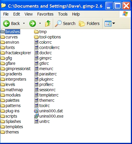

I wonder if it is a conflict between the .gimp resource folder and your F drive resource folder.
Where exactly is your GIMP_2 Directory? ie..... the (.gimp-2.6/7) folder. It may have to be in the same directory to work.
If you mean my user folder it's like I said above...C:\Documents and Settings\Dave\.gimp-2.6\brushes (for instance) Gimp is on my F drive with the new "GIMP Resources" folder outside of gimp that contains 4 folders...Brushes, Gradients, Patterns and Scripts.
You can see the path at the top of each of these screenshots and the contents of each.
